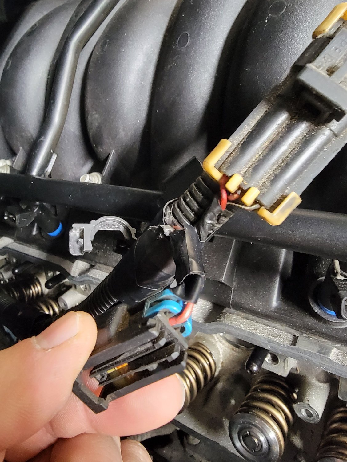

Can anyone tell me what connectors these are just got the car as a project and the previous owner cut the injector plugs off and wired on some different style, my injectors are Ev1 but there not fitting those or the ev6 to ev1 adapters I have its a cobbled mess so far

Looks like a EV6 connector

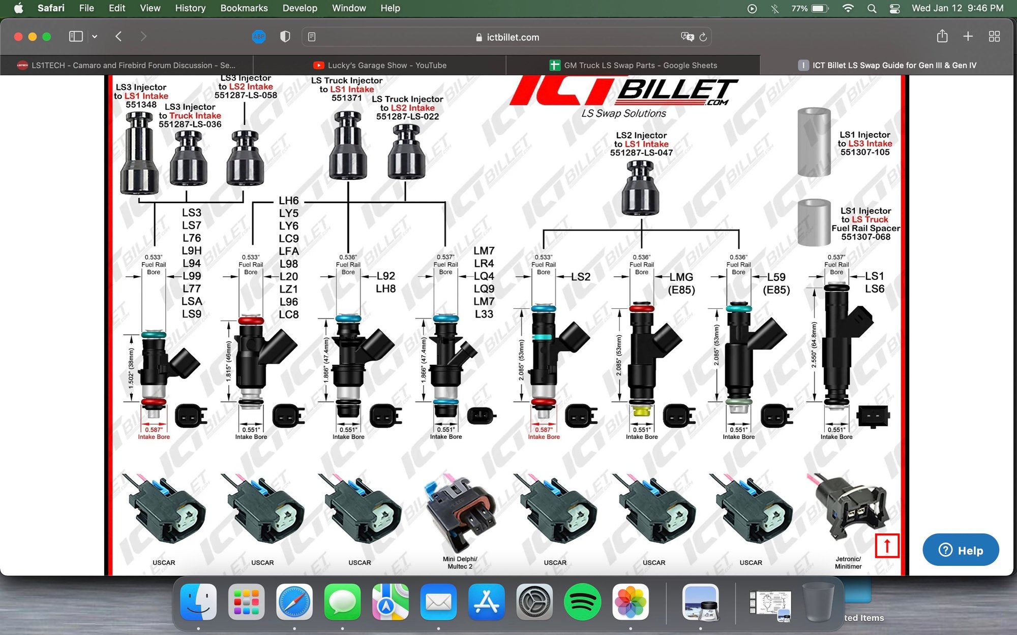

Check this !

Your connectors that you have are USCAR/EV6. The connector on your injectors are indeed EV1
