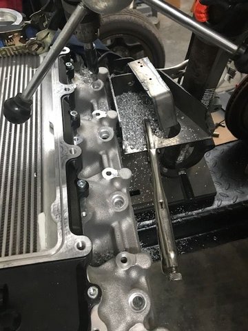

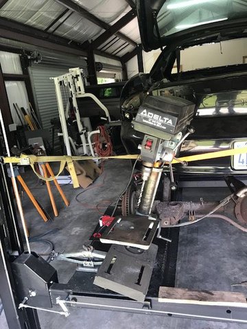

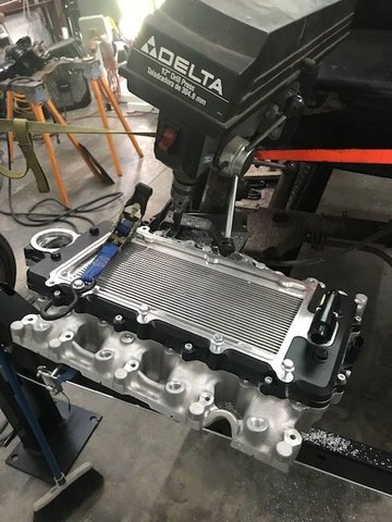

Here is the Gen 5 Whipple intake meant for DI, now drilled for port injectors. Beware---Some shade tree things. I needed a level base with an angle on the drill. No special equipment needed. My back gauge is a panhard bracket from Midwest Chassis.
