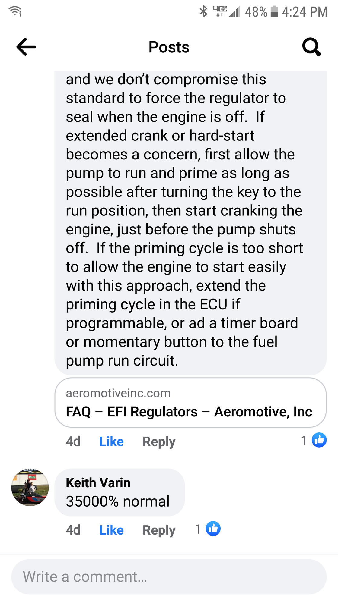

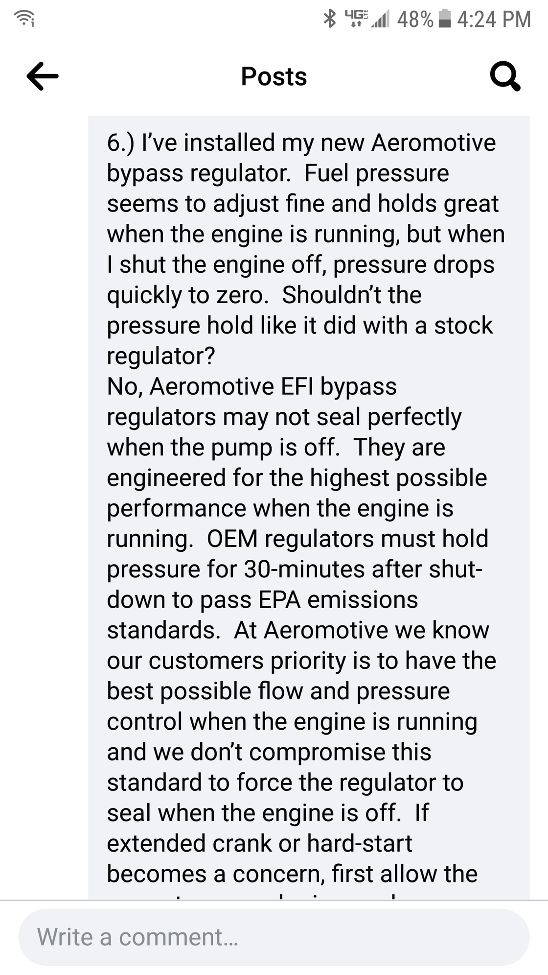

The regulator is a Hyperfuel. I spoke to there customer service guy and he said that it was normal for the pressure to bleed off. I posted this question on the boosted LSX Facebook group and here was the reply that I got. Click on the images.
