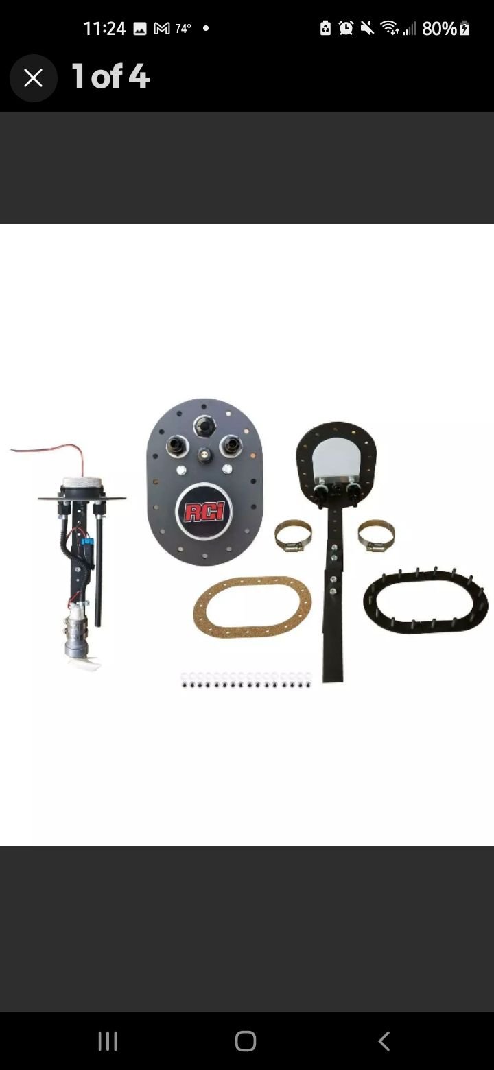

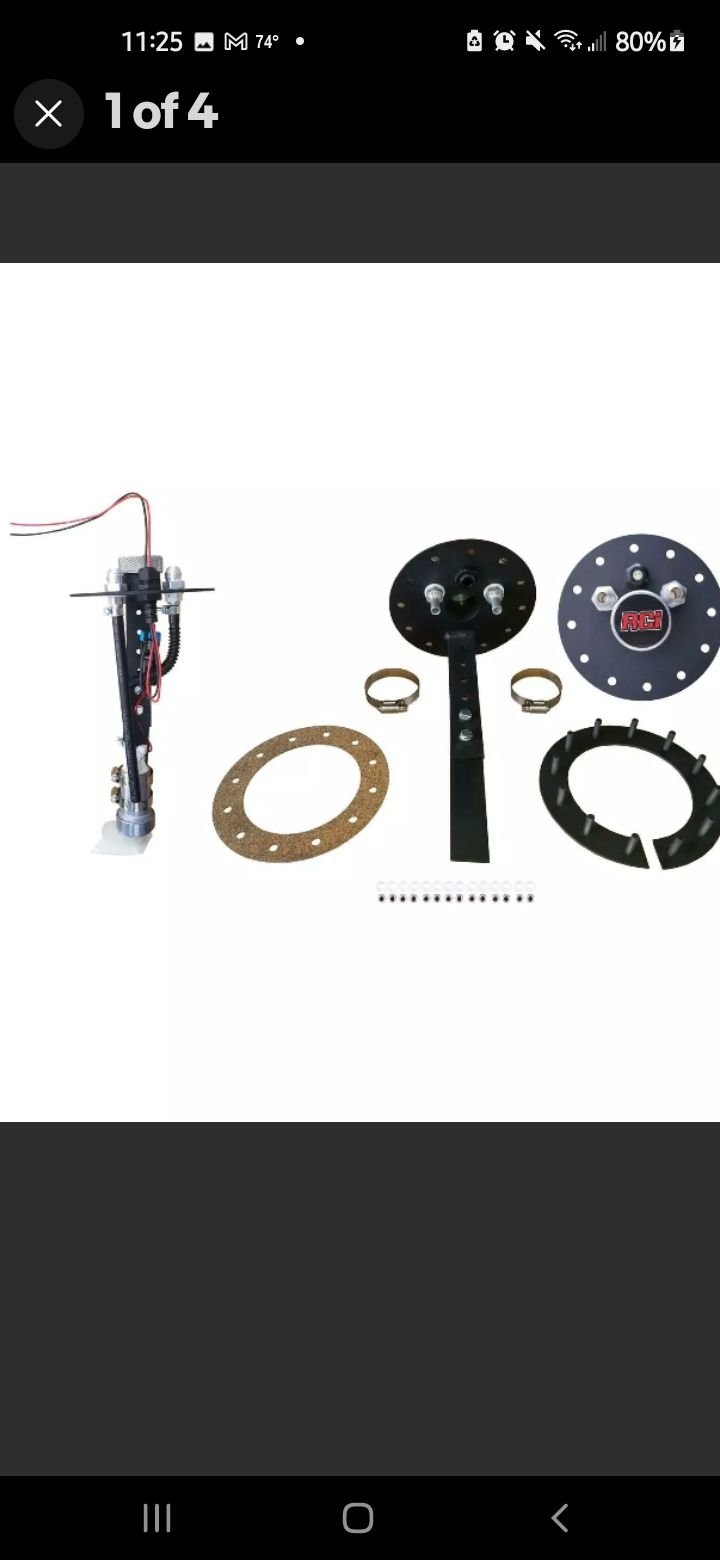

I have grown to like intank pumps more than inline external, not counting the big magnafuel or aeromotive pump. Like I mentioned earlier I like to use these to do internal pumps in a fuel cell.
I like to use these, mainly because i use multiple pumps and theres plenty of room to slide the assembly in. Part #7082a
Here is the smaller 1, part # 7080a. It may be a direct swap for your fuel cell, it's a 12 bolt flange.
last time I needed 1 nobody had 1 of these, so I had to get the 7032b and make my own hanger assembly. You also may want to baffle the tank, I put the pump(s) all the way at the very back and haven't had a problem. If you have a really large cell yrmv.
For what you're wanting I would do an intank walbro 255lph or similar. That would give you some head room if you ever wanted to hop it up na.
