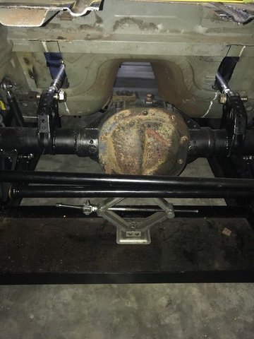

Another problem is that I am using an 8.8 Ford rear with a 4 link which will hit the plastic tank. Has anyone rearranged the sheet metal with the tank brackets, and moved the tank back 6" ?

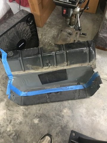

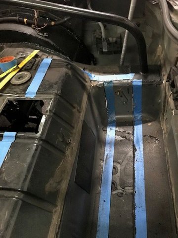

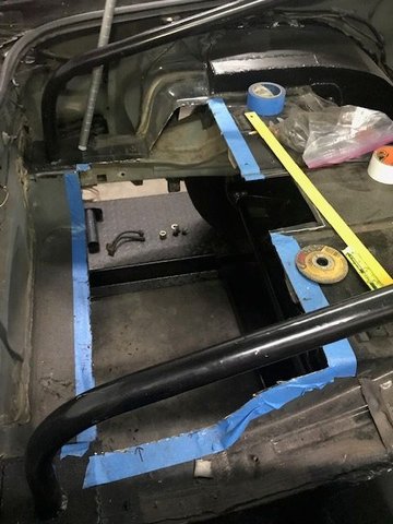

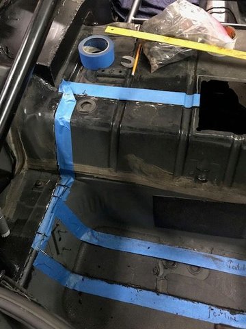

I went ahead and made room for the stock tank by moving it back 6 inches to have room for the 8.8 pumpkin and upper 4 link bars.
I will clean up the edges, tack weld it in and make a filler for the top. Then I can make a couple of brackets for the front mounts (where the tank strap bolts in).
8.8
Cut lines taped off
Cut out complete. One more cut to remove the 6"
It's a big hole
Where it will be located. Just made the T top storage 6" smaller
Now I don't have to buy a new fuel tank

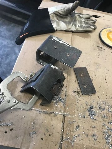

These are the front fuel tank brackets that the straps bolt to. I made a couple with bolt backing plates and bolted them in to the channel..
I welded nuts on the two little straps. They slide into the channels above the tank, and I bolted the brackets to them.

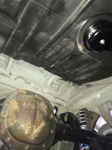

Lots of room in front of the tank now.
