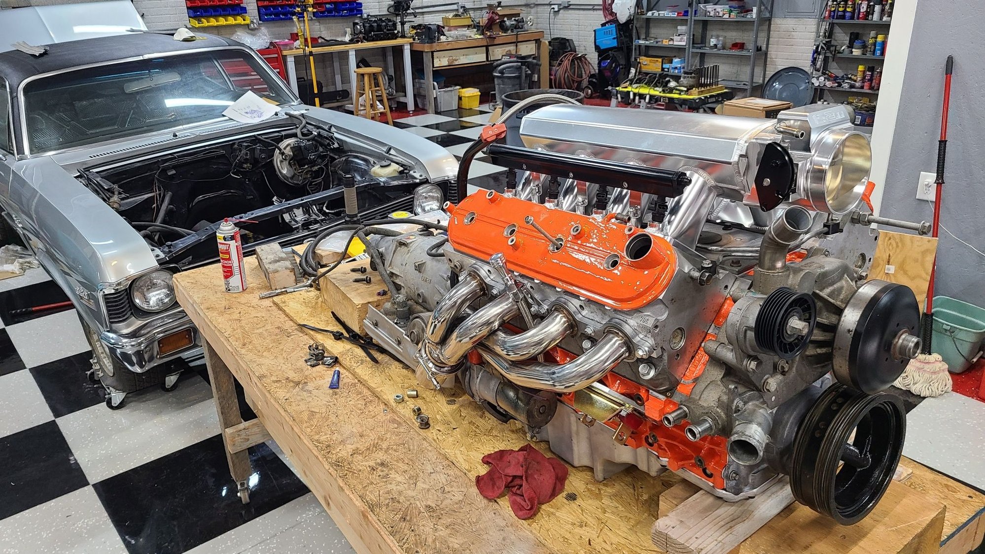

I'm putting an '02 5.3L LM7 truck engine in my '70 Nova. I have a low-profile sheet-metal 102mm intake that apparently uses EV1 injectors with its included rails, so my truck injectors are too short. Is there a set that will support around 400hp without spending $300+? Do I need hi- or low-impedance? I plan on using the truck's ECM with a PSI or BP Automotive harness. Speaking of, which harness do you guys like? Thanks!

High impedance injectors is what you need
