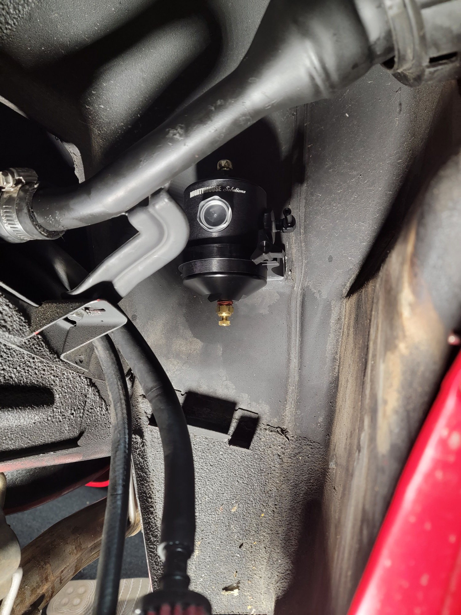

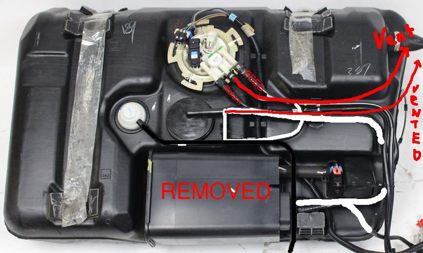

Question regarding the vents. I have removed all EVAP off my car and I am running dual pump set up. Please see pic below. I have "whited out" what was removed and marked up what I am venting. I ran lines all the way to the fill neck and have some filters just to keep it clean.
The issue i am having is even though the lines are routed all the way above the fill neck (in fender area) when I fill up the tank I am getting some fuel that drips out still. It is driving me nuts. What am I doing wrong lol
You can see the two lines dangling down low in this pic below however normally they are zip tied to teh fill neck and stuff up in fender area.
