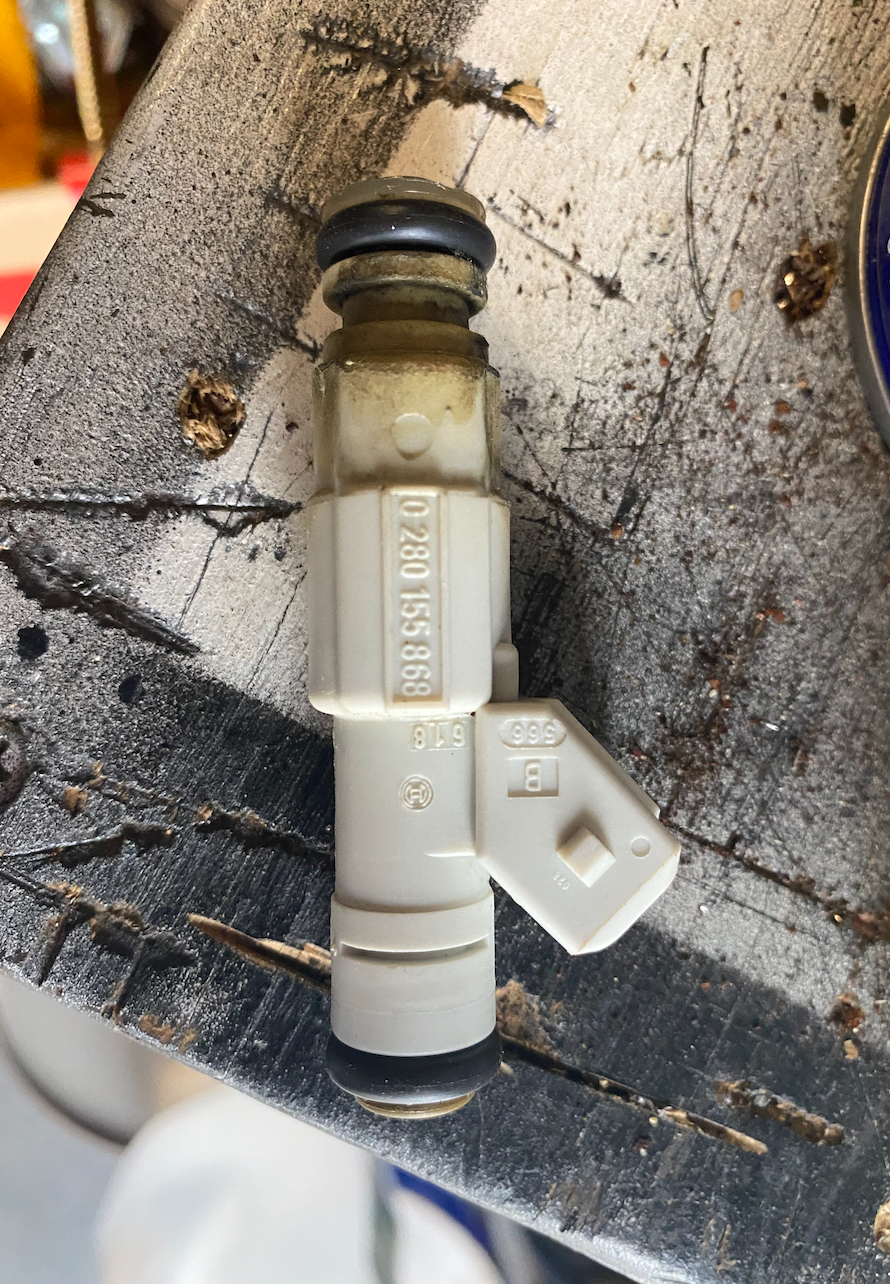

I am adding a Procharger to my L20 engine - I have a 92mm throttle body on an MSD Air Force intake. I was using the pictured fuel injectors and I believe I need 80 lb for the new setup. Which injector am I currently using so I can buy the right fit injector

That is an early LS1 type "tall" injector. They should be 28 pound injectors. Bosch TPI injectors are within a millimeter of the same size so it should be a direct swap.
