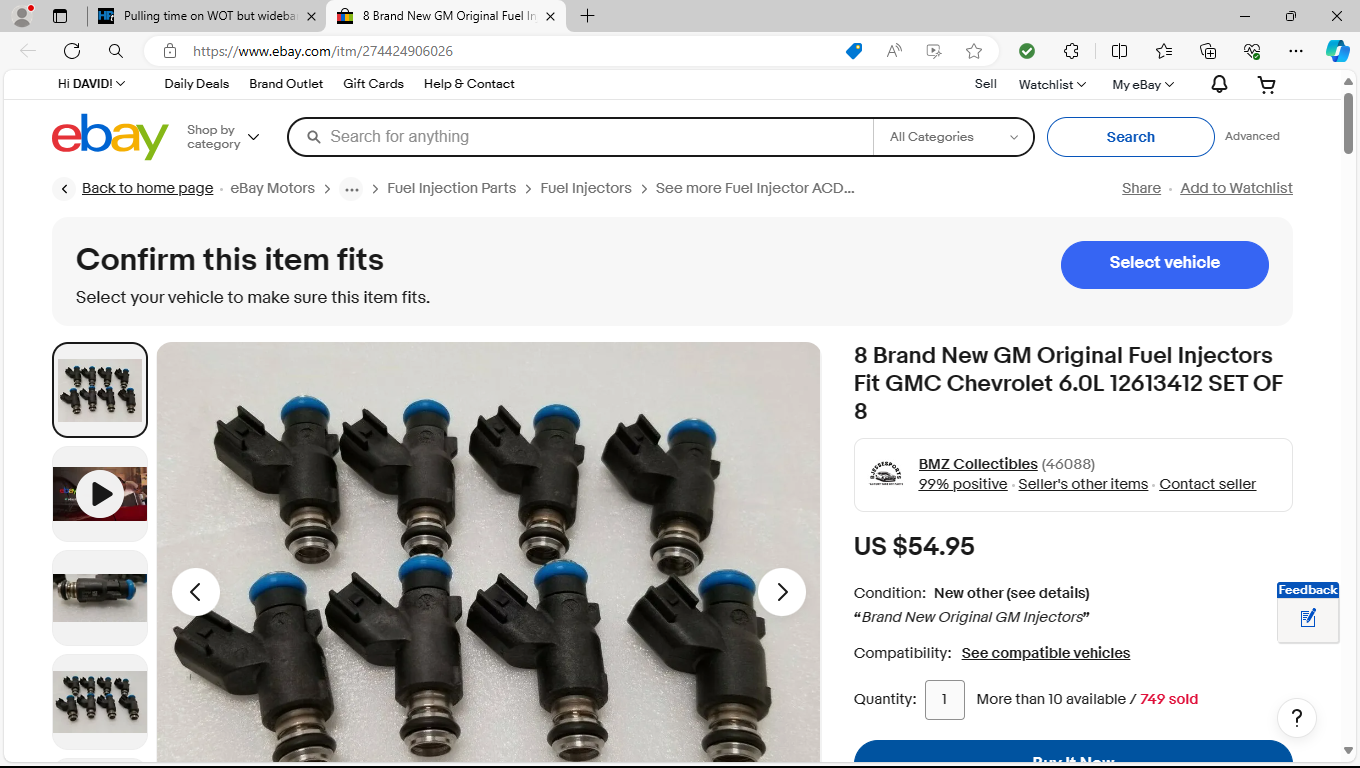

I am not sure what an LM7 is but if you need new GM injectors, go to ebay and look up 12613412. They are GM 51# injectors and you can get the data on HPTuners or PM me and I will send it to you. These are for a L96---not sure what fuel rails taht you have with that setup, but see if they will work. At 55$ a set, it's hard to go wrong.

I wouldn't trust anything from eBay anymore. You can get used GM LS3/LS7 injectors for $100-125 shipped if you look around on the forums and FB marketplace (42lb/hr). With adapters you can make them work. Back in the day I used Ford Red Top injectors (30lb) in my LS1 with AFR heads/233/239 cam, LS6 intake manifold (made 440rwhp).
