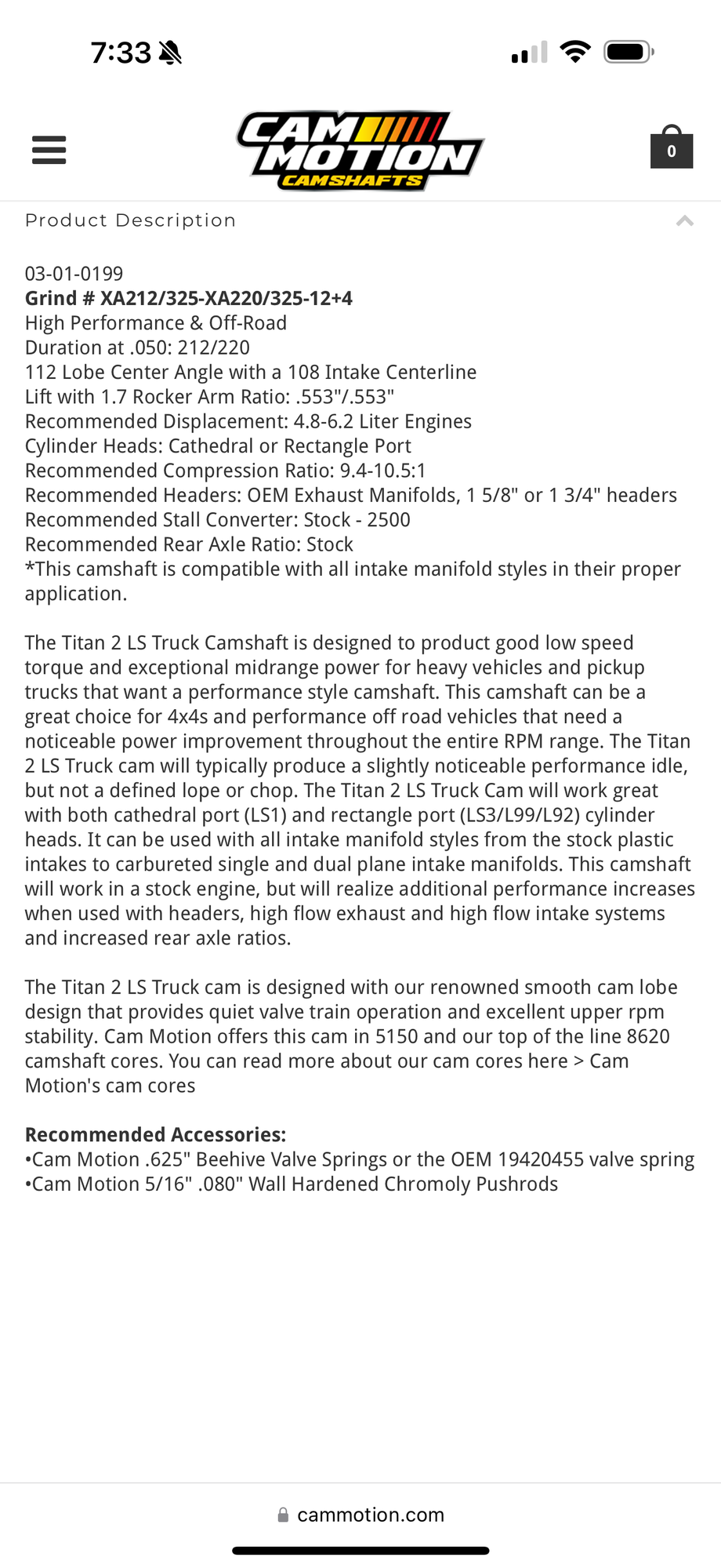

Lq9, 823 heads, L92 intake. Cam motion cam. It’s literally a cam only engine. I’ll be running a p01 computer as its drive by cable. Should be making between 450-500 hp.
ls3? Fuel injector clinic 60# Ls3/l92 injectors? Those are my two options.

WHICH Cam Motion Cam? It matters.....
Old Oct 2, 2024 | 09:34 PM
06pbmKC's Avatar
Joined: Mar 2015
Posts: 153
Likes: 28
https://cammotion.com/ls-camshafts/t...212-220-112-4/
