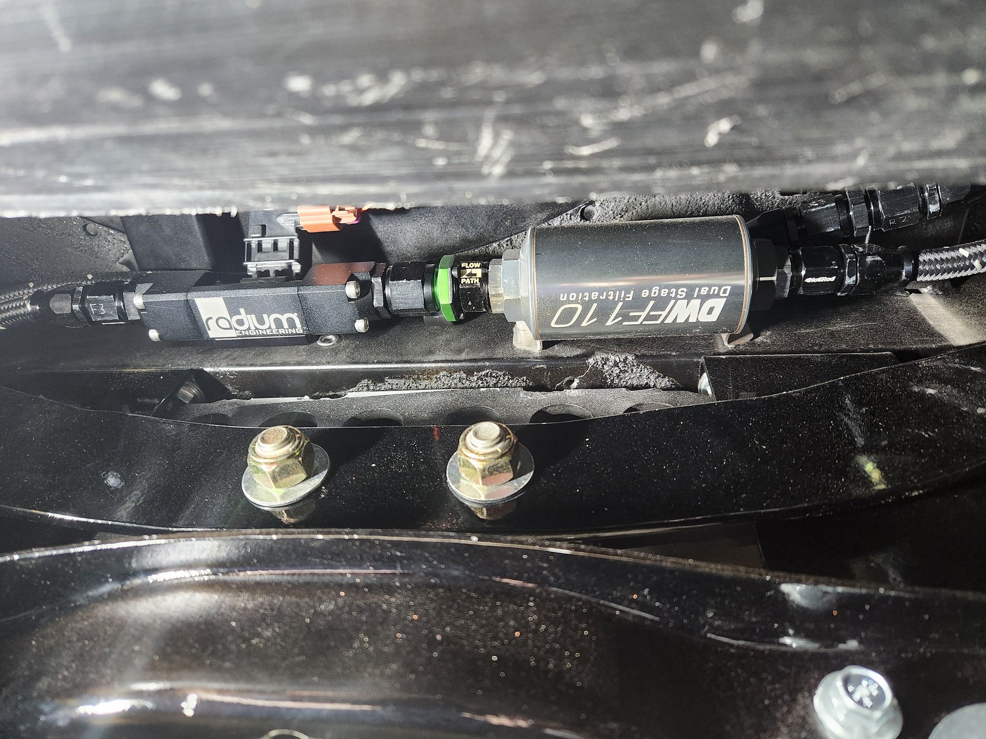

Radium 20-0589 Split-Flow Flex Fuel Sensor Adapter
Radium 20-0534 Universal Check Valve

Tank->hydramat->pump->filter->check valve->flex fuel sensor->fuel rail inlet->fuel rail outlet->fuel pressure regulator->return line to tank

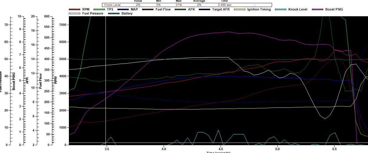

I have only driven the car a few times before winter set in. Out of the few times I have driven it the fuel pressure has dropped sharply from 44 psi to 15psi. This isn't a gradual drop, it's very sharp. It has only happened in 2nd gear for whatever reason. When it happens, the car instantly loses all power. Then inexplicably, after I let off and get back in it, during the 3rd gear pull it's steady up to 6k. Car was running 1/2 tank of gas during the pull.
I've attached a log file to show what I am taking about.

-Put the flex sensor on the return line.
-Consider an increase to a 10-micron filter, or get a much larger 5 micron filter.
-Those check valve fittings are terrible.

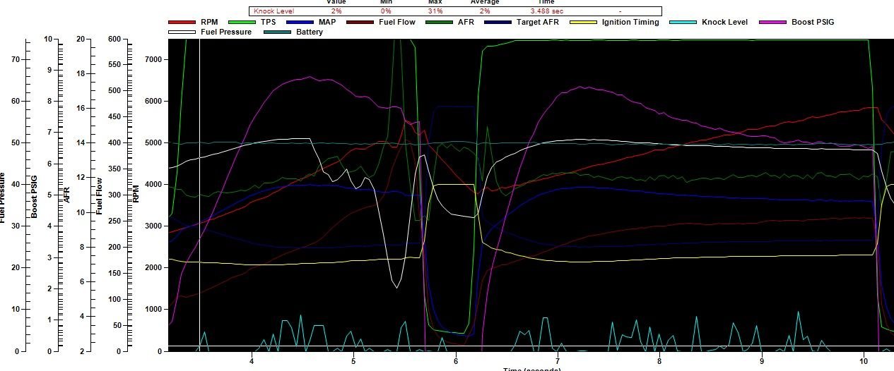

Screenshots of the datalog (fuel pressure in white)
Entire pull (2nd and 3rd)
Only the 2nd gear portion of the pull:
