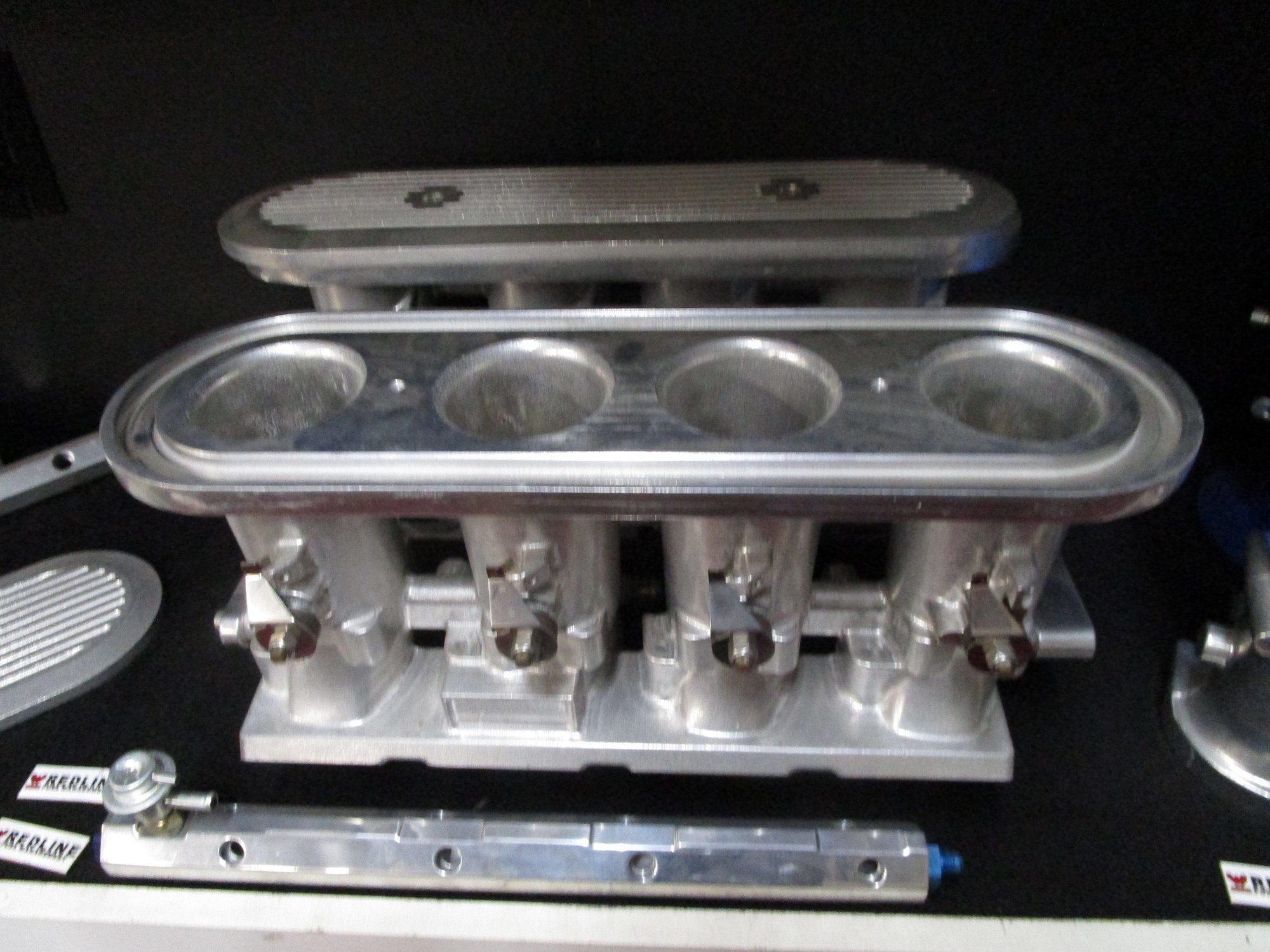

Default Two cast tops
Built with Air Filters and tops, CAST AL.

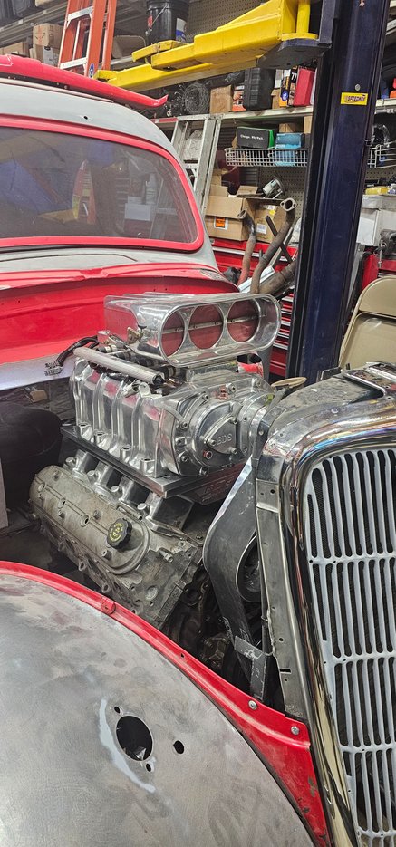

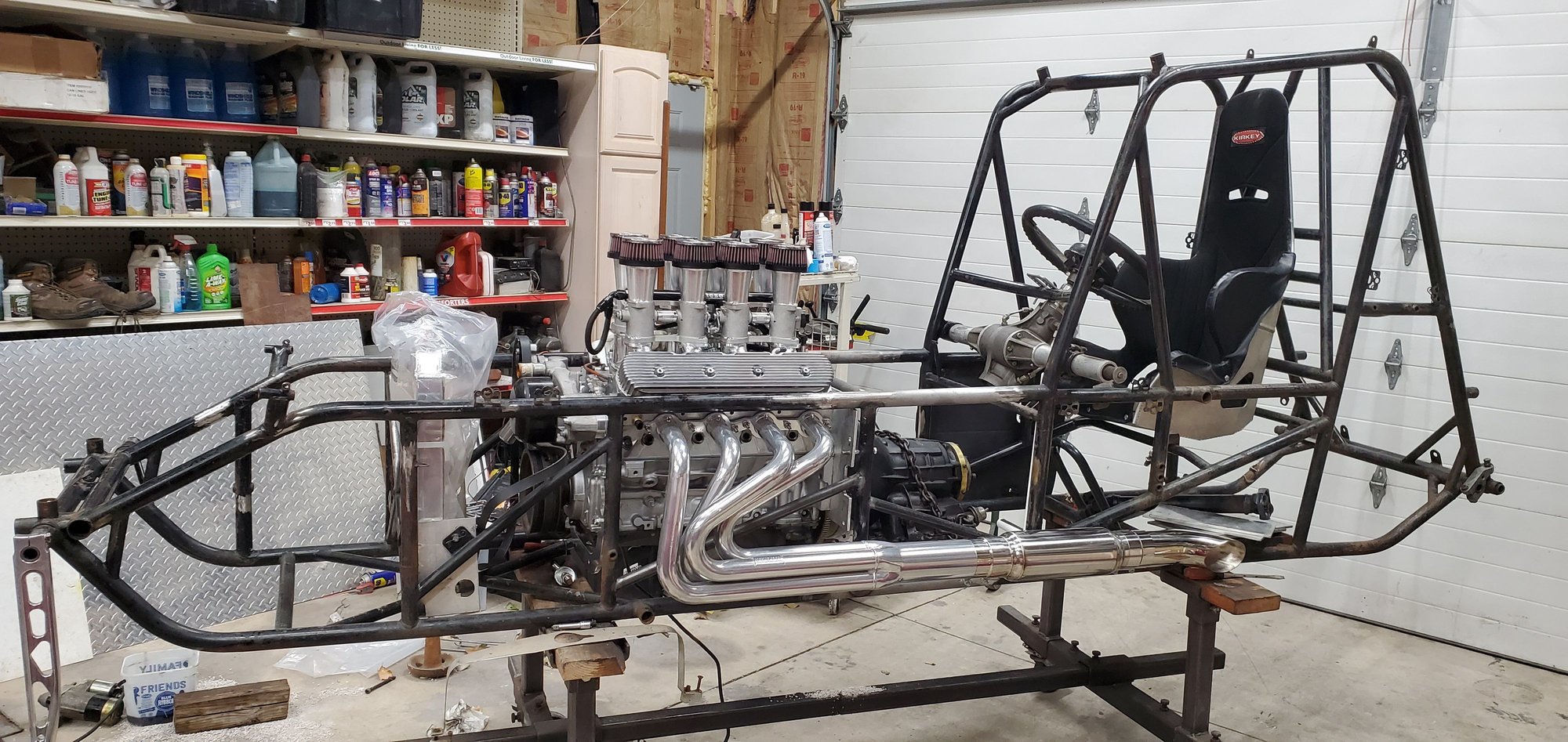

I also have a ITB project that I'll run with a Holley system. It makes tuning so much easier, Someone mentioned that tuning ITB's might be an issue. The biggest issue is that they need a common plenum to read MAP, I have an Inglese setup that has a common plenum built in the bottom of the intake. synchronizing ITB's is actually pretty simple. It just takes a little time but just about anyone can do it as long as they stick to the procedure.
Here are some pictures of my projects - Street legal sprint car and my 35 Ford Five Window.
