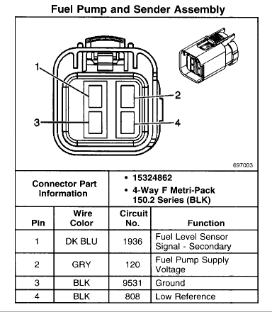

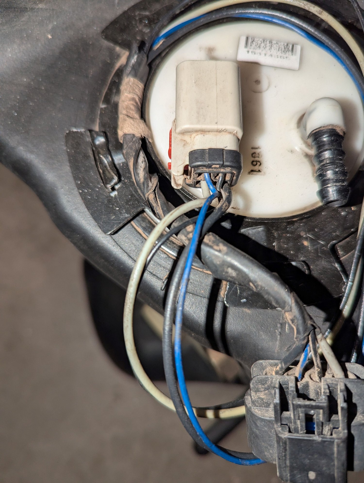

Hooking this up to a Haltech ECU. I need a little help identifying some wire colors on driver side fuel pump from a C6.
I know one of them should be for the fuel level and one powers the pumps to injectors. Not sure which one is which though.
White (ish) - ?
Black - ground?
Dark Grey (thicker gauge than black) - 12V maybe?
Blue - fuel level?
Thanks

I also found something similar. This further clarifies it. Thanks a lot.
