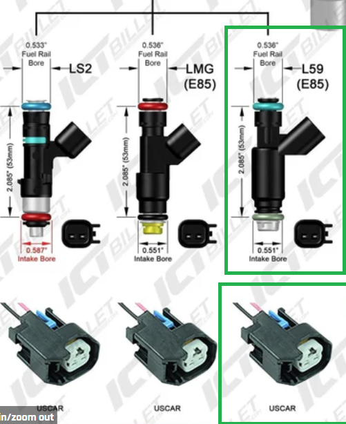

I bought adapters from ICT billet. The injectors are 100% the dimension of right hand side. The connector is that one as well. I've been running them for a few years now... However, my tune is getting more nuanced. Hired a professional tuner to help me and I thing we isolated some of my issues to be due to inaccurate injector characterization.
