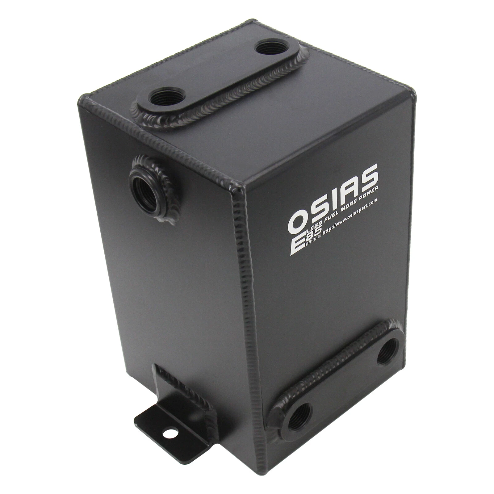

Doing the math if it's correct, if 2 pumps are pushing 800lph, and my truck is slow AF and I'm in boost for 15 seconds, I'd need 3.33 liters not accounting for the lift pump constant fill or return. So I'd probably want a 3L?
Basically run the factory pump to fill something like this below. Dual inline pumps off lowest ports, 1 switched for X psi to rails, afpr return to surge tank, and surge tank return to fuel tank.
Fit Dual 044 Fuel Pump 3L Black Universal Fuel Surge Tank With Y Block Bracket - Picture 3 of 9

I run one similar to this

Did either of you have to modify your tank other than adding a return line port from surge tank to gas tank?
Curious if In need to add a line to the breather so when I fill up with gas it doesn't click off constantly or early.
Old Feb 2, 2026 | 03:11 PM
Bbknucks's Avatar
Joined: Dec 2022
Posts: 444
Likes: 158
I run a fuel cell
Old Feb 3, 2026 | 12:42 PM
Forcefed86's Avatar
Joined: May 2011
Posts: 8,487
Likes: 1,034
From: Wichita, KS
No, no other mosifications necessary.
