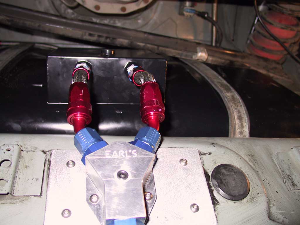

Okay, but if the Weldon pump says to use a -12an in, then you definately would need to use the two ports on the sump, since a 1/2" NPT isn't nearly as big as a -12. What I was referring to was systems like this:

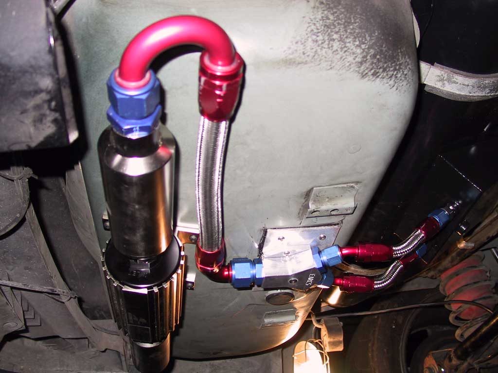

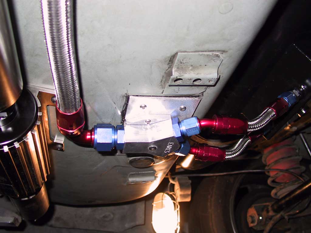

Thats Harlan's car.......... I only did one of the outlets using -8 and a plug in the other...... ill be doing it like Harlans using dual -8's into a -10 later down the road.... heres a pick of how mine is done now.
