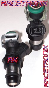

Originally Posted by xXxSilveradoxXx
Is anything needed other then the Driver Box to run Low Imps Injectors? Will they fit on the stock manifold/fuel rail?
Most HP injectors like the Siemens 3105 are a bit taller than the factory GM Multec 2 SUV injector. Most people shim up the rails and change the connectors.
