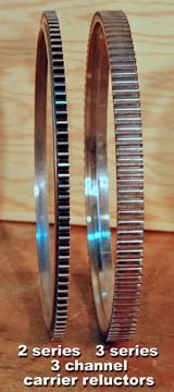

Can anyone tell me I have a series 2 posi and am switching to a series 3 will the abs gear fit on a series three Eaton posi and how do these install on the new units

A 2 series reluctor ring is different than a 3 series reluctor ring. The ring gears flange rim is in a different position and a different ring is necessary to be able to actuate the sensor.
They 'tap' ,carefully,off. Putting one on is a little more difficult because of needing to start it evenly.
It's an ABS rear end,not a ABS & Traction Control rear end. Traction Control rear end has the rings on each axle near the brakes.
