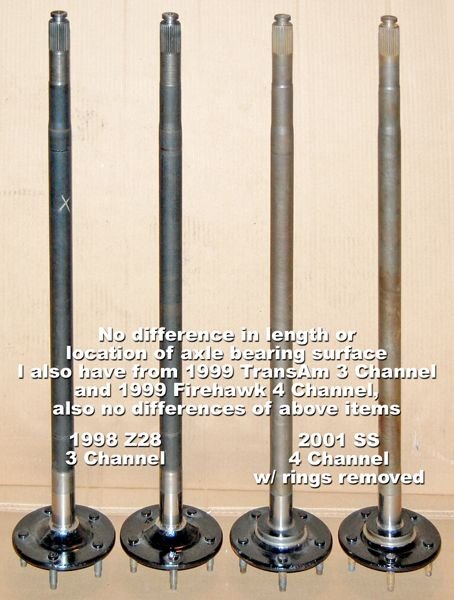

Which comes to my current dilemma; through and friend at work I found a guy who was replacing his axles for stronger ones because he turbocharged his car. His car is a 2000 SS A4 with 3 channel abs and no tc. My question is will these axles work in my rear end? I know my abs light will be on and the traction control won’t work. That doesn’t bother me.
Ive looked into getting new axles from moser but If I can get these axles for free so if I can use them I’d rather do that. Any information will be greatly appreciated.

Did you remove the channel ABS/TC sensors from the brake backings plates ? they also will not allow the axles inward.
In regards to your question,yes the axles will work. All axles (V6,V8,ABS,ABS & TC) are identical in length and surface that rides in the bearing. You just won't have the 'diameter' to press on the tone rings.
