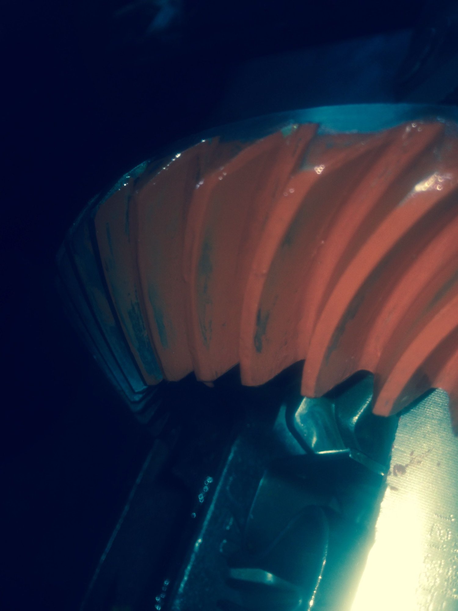

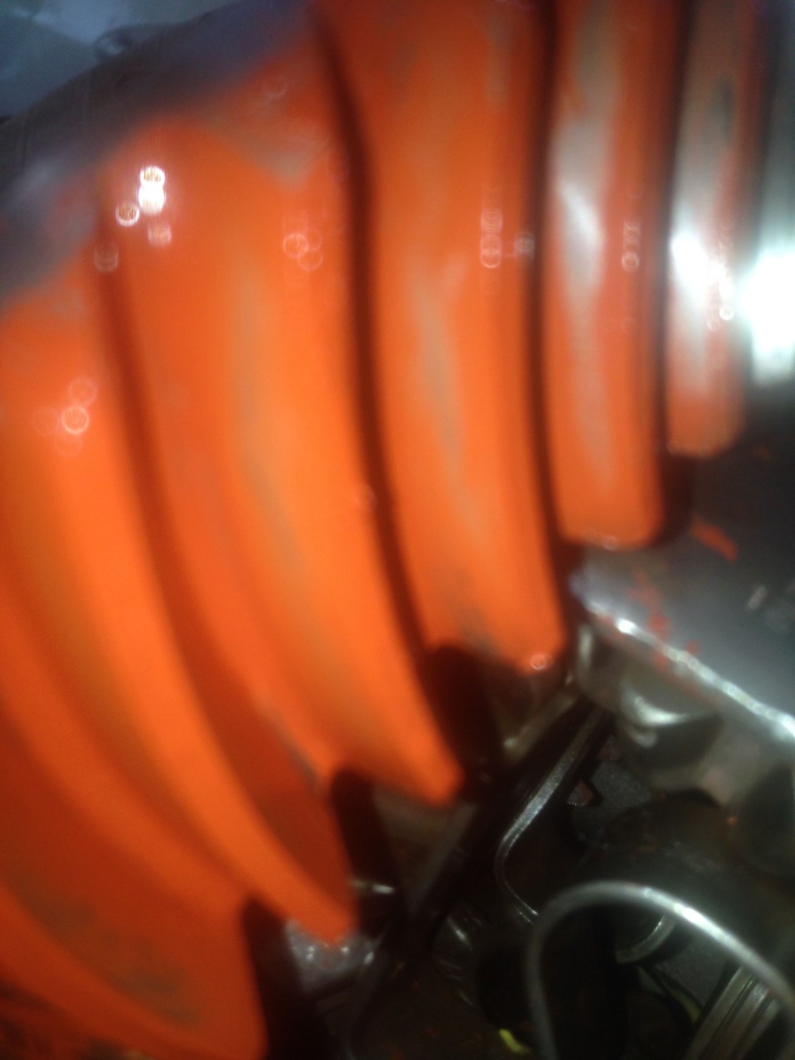

this is used gears set and i dont know this pattern is acceptable or need some adjust
both drive and coast side is between toe and heel with good telorance BUT on coast side i feel high contact(face contact) pattern

While somebody with experience answers you, I will say that it is shallow, coast is on the face and needs to be more centered towards the flank. Images are also blurred for the drive side, whats the current backlash?

backlash is .010
i will add .002 pinion shim to see the result
