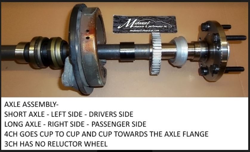

So I'm prepping for my 9" install and the axles came in before the housing. The housing is suppose to show up Thursday while I'm at work. What I wanna do is get my backing plates with the axle bearings all together before the housing shows up so it makes install go by quicker for the weekend. I was wondering if anybody can chime in and tell me which axle goes to which side cause their different lengths. Any help would be appreciated. Thank you

I do not know who's 9" you have but if it's built the typical way for a nine inch this is some helpful advice.
