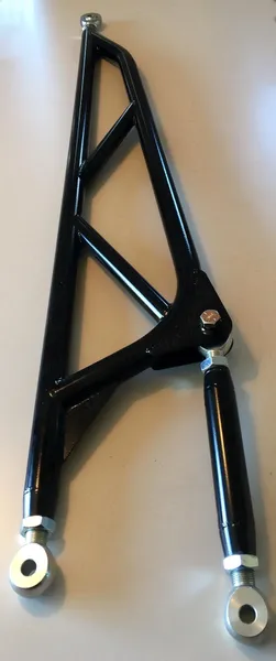

would like to get rid of their adapter and go with a one piece torque arm. The Moser looks like it might work, anyone tried it? Other ideas out there, other than ditching the rearend!

The mounting distance of a standard torque arm will not work. We have multiple customers purchase our two piece torque arm and modify the existing brackets on the housing to work. You in theory take the inner bracket and make it the outer bracket. So there is some fab work required.
