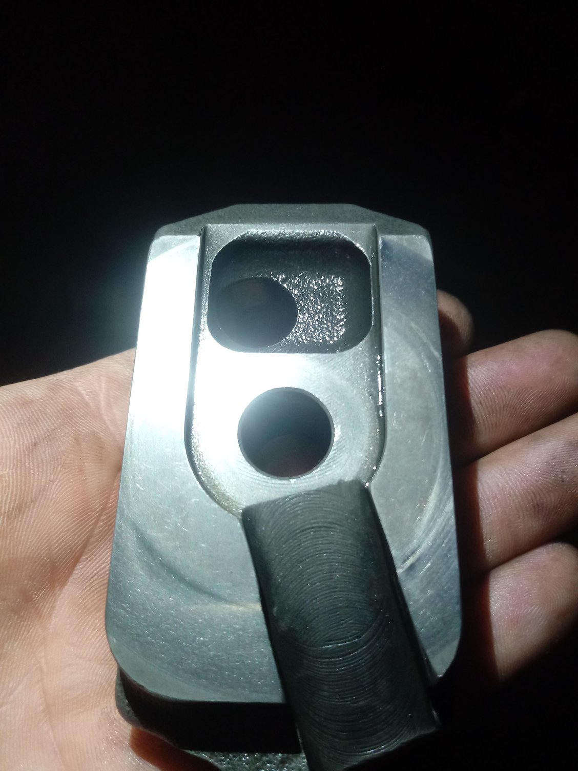

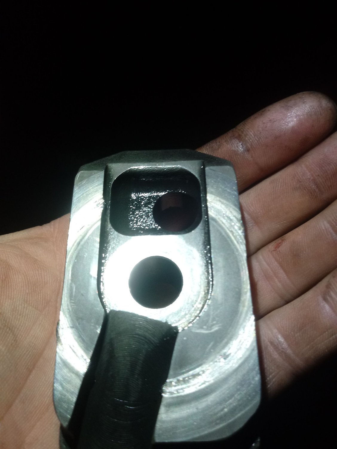

Picked up this rear off a 02 SS . Teeth look ok but im no expert . What do you guys think? But what really has me concerned is scoring on the paddle . One side is good but the other side has some bad scoring. Big circular scoring.
Is there something seriously wrong with this diff or what can I do.

There is nothing wrong with the 'paddle'. It is very hard and tough, never seen one 'wear out'.
What is the differential supposedly out of, M6 or A4 ? Need better pics of the ring gear teeth.
