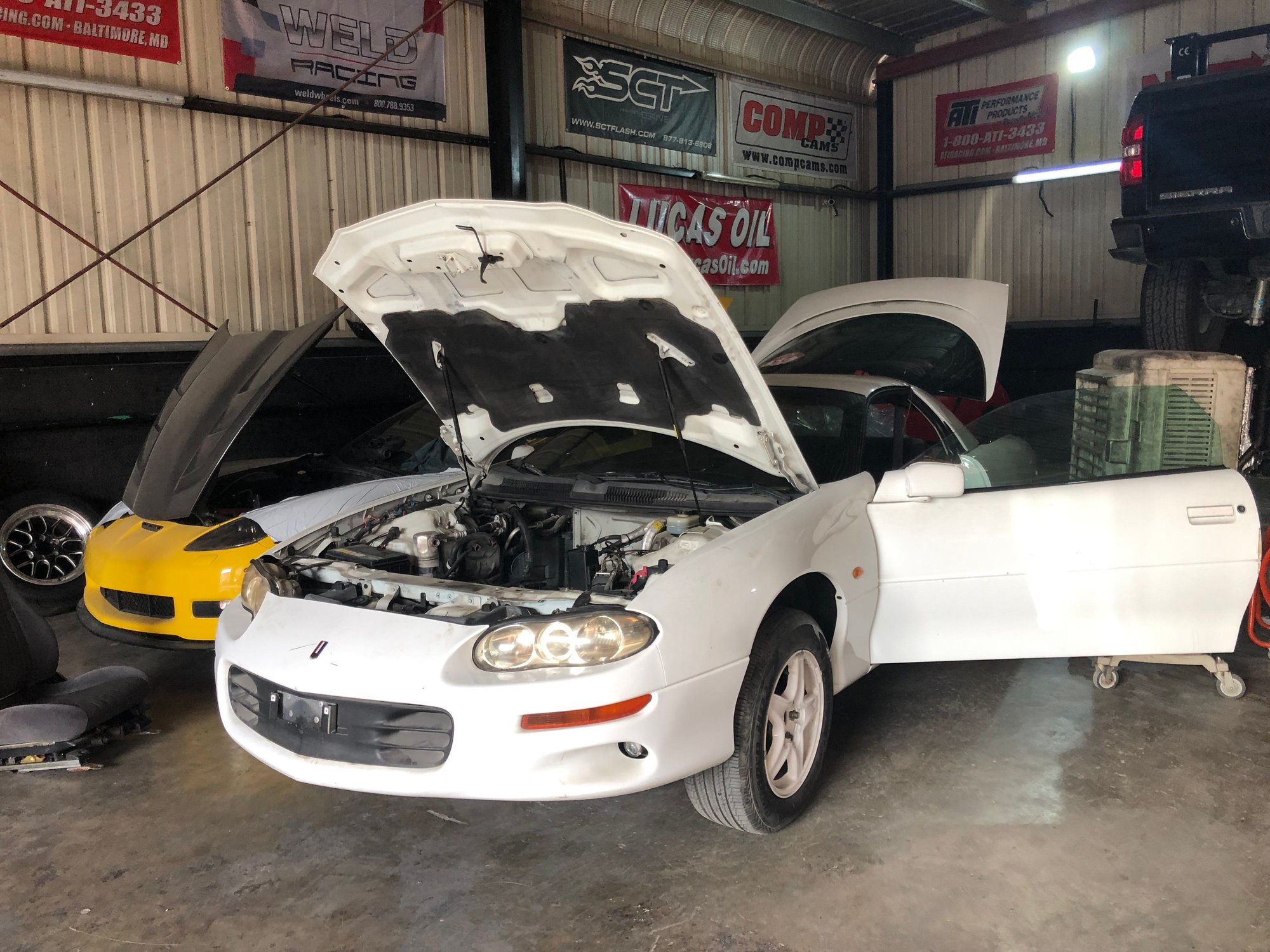

Hello guys,
I have a 1998 Camaro F body that I am building for drag racing it has a stock bottom LQ4 6.0 with a single turbo, I am stuck between the 3 rear end options and kind of lost
to what to pick for my car. The car is only for drag racing I am not planning to drive it on the street, and horsepower wise for now looking at 700 but future to make it reach to 1000HP.
Any help with what option is best for me between the Strange S60, Hawks 8.8, Moser 9inch?
My tranny is Th400, looking to have mounted on the stock brakes I already bought a UMI torque arm, panhand bar, extreme anti roll bar, rear lower arm
and planning to go with afco suspension kit. 15inch weld racing
