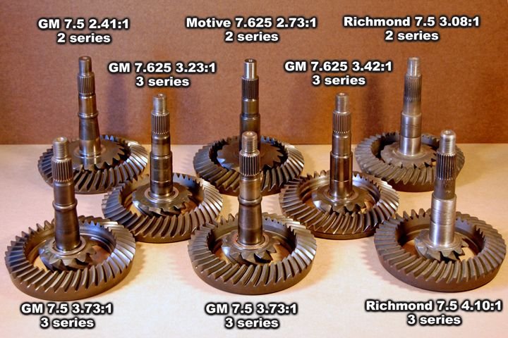

Here's another good pic for reference.
Disregarding the back row for 2 series, the front row and middle row are for 3 series. As the ratio get numerically higher (3.23-3.42-3.73-4.10) the pinion gear diameter decreases thereby requiring a thicker ring gear to maintain the critical pinion gear centerline to ring gear flange mounting surface dimension.
