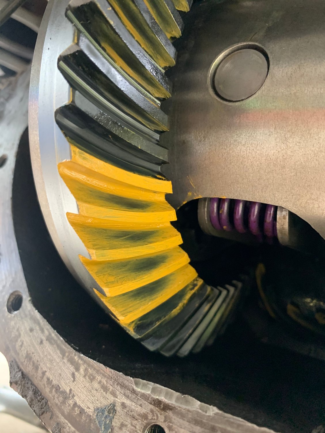

Looking for advice on gear mesh pattern. 8.2 10 bolt new Yukon gears and posi. Started with a .03” pinion shim, and have been moving down .005” increments to .015” which these are the results of. .007” backlash. Looking for opinions, pinion to close or is this acceptable? My first full rebuild.

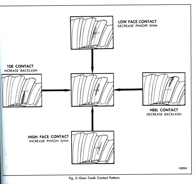

'Coast' looks good,'drive' looks terrible.
According to pic,pinion shim needs to increase and backlash needs to increase to center the pattern on the 'drive'.

So I build diffs for a living and for 8.2 10 bolts with Yukon gears I usally end up running between .023"-.025" @ .007 backlash. I hope this helps. First pic pinion is too deep.
