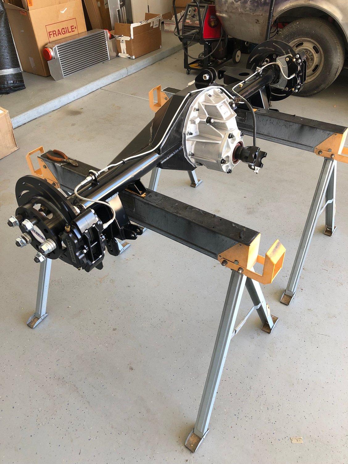

If you only want to do it once :
That is one sexy unit bud! I wish I could say I did it once but I'm doing it right this time around and going MWC

[QUOTE=gjohnsonws6;20362025]If you only want to do it once :
Is that a brake line kit from Strange or did you just run new lines yourself and what size 3AN or 4AN?

[QUOTE=01CamaroSSTx;20362105]
The Teflon lines and bulkheads are from Midwest, I bent/flared the hard lines myself. -3
