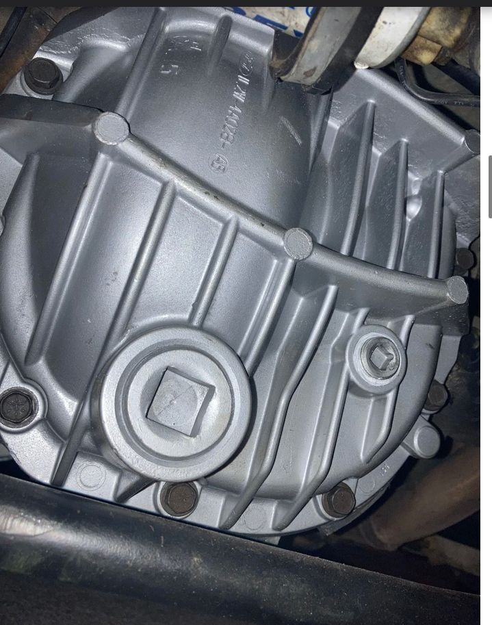

I am running the GT500 finned cover on my 8.8 with an MWC Watts Link, and it clears, has functional cooling fins, fill/drain plugs and a port for temp sensor. It doesn't put preload on the caps but I am also putting around 500rwhp through it without any problems so far.

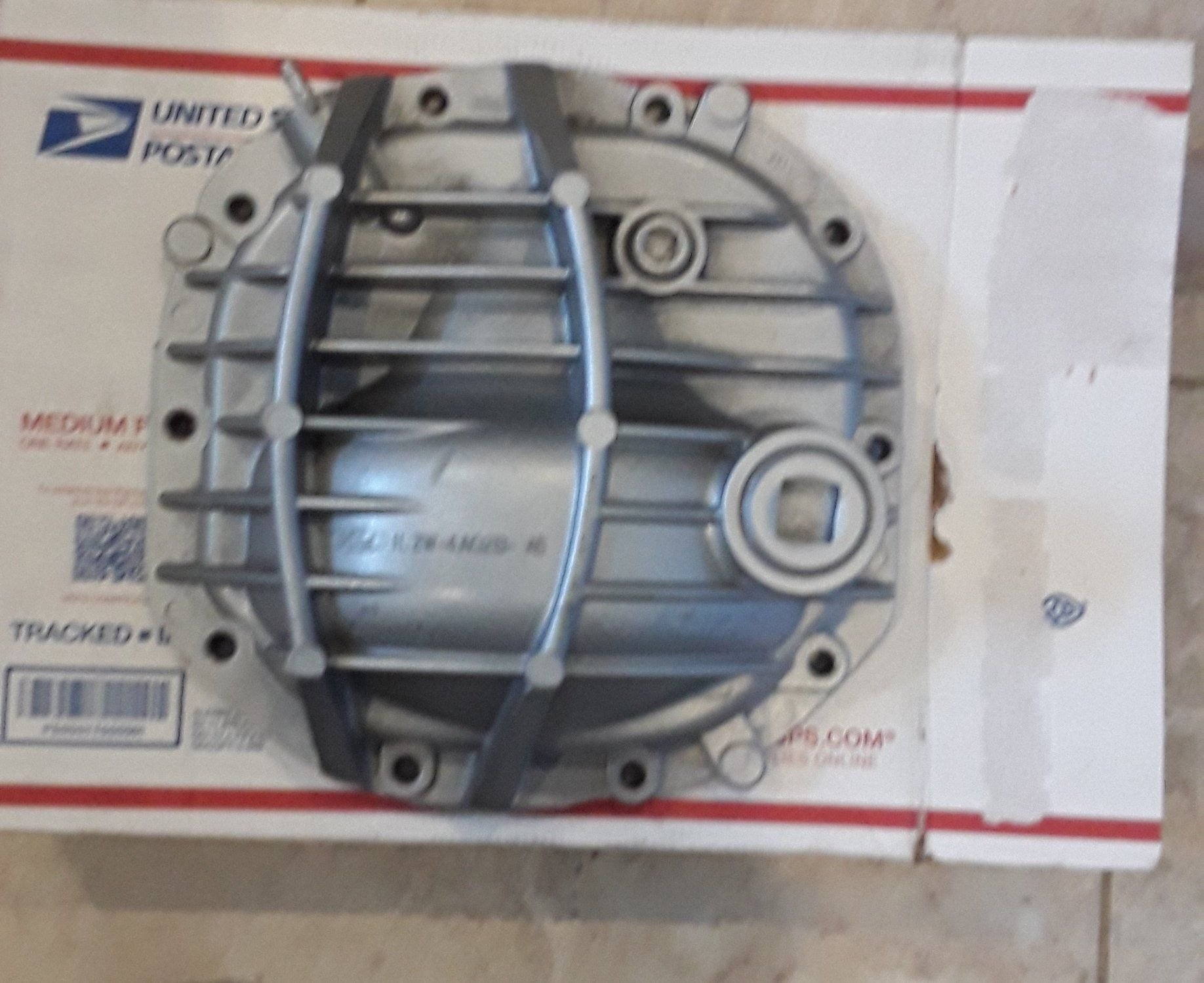

I have this one on a ‘95 Mustang with the 8.8”. It’s strong, has some fins and it has a fill and drain plug. The best part is that it’s only $65. Or you can DIY it because it’s an OEM Ford Explorer differential cover with the “wings” cut off of the sides. I realize you’re looking for a girdle style, but I can’t imagine a girdle saving a rear end that was gonna go, but maybe so.
8.8” Explorer Cover
