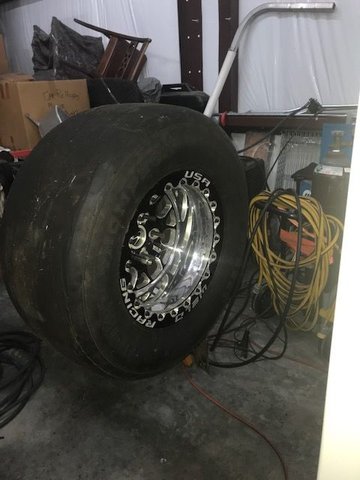

Wheel shot

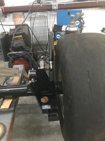

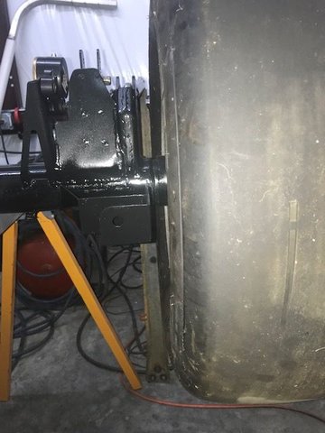

Clearance shot

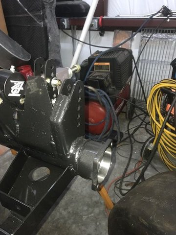

Tire to LCA clearance with 3.5" backspace wheel and 275/60-15 MTpro
Narrow LCA bracket for tubular arm
I am mini tubbing for this tire since the car will be lowered. The LCA dimension on this would be the same as if you got the offset LCA setup and get rid of the stock LCA. It is too wide. Or use a more narrow tire. I may be using a smaller tire also. This is a 8.8 Ford rear, but narrowing a stock rear would be the same, only easier.
