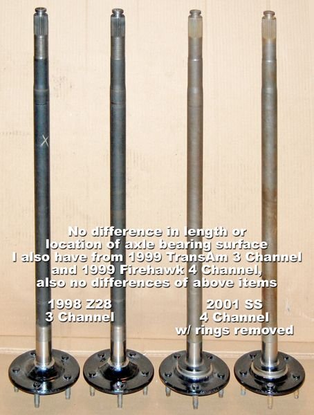

I'm putting this rear end into a 3rd gen so I've removed all the ABS stuff. My question is will a non-traction control axle shafts work with this rear end? Summit says no....
Differential Case Design Type: GM 7.625 in. versus 7.5 in
They are both c-clip and both the same length....I'm thinking they will fit. I will know in a few days but confirmation might help me sleep better.
I have to replace the axle shafts on the rear b/c one of the flanges is bent.

GM 7.625" vs 7.5", everything is the same/identical except for the ring & pinion gearset. GM made a slightly larger gearset to handle more horsepower.
Non traction control axles are the same as traction control axles dimensionally.

Summit says no because people generally want to keep their traction control. If you're not concerned with it then they will work.
