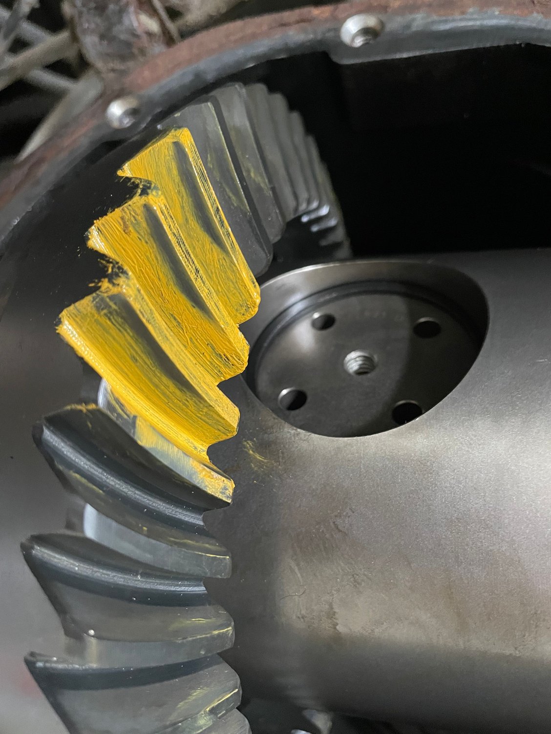

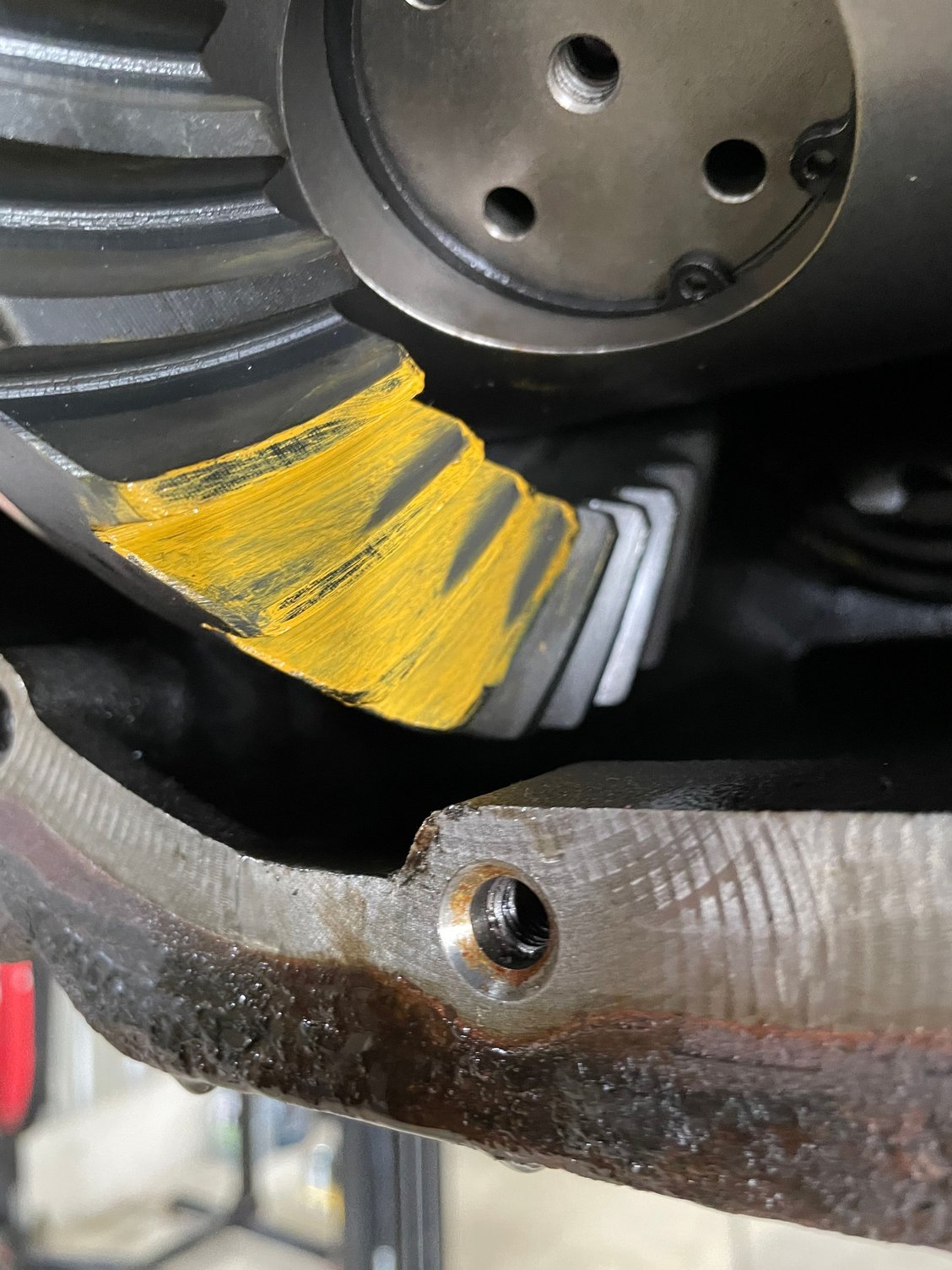

Pinion depth? 0.0085 backlash

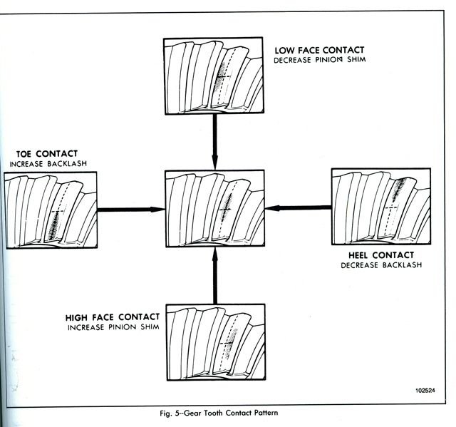

Looks like it's a matter of increasing pinion shim and decreasing backlash.

I think you are right, thanks
