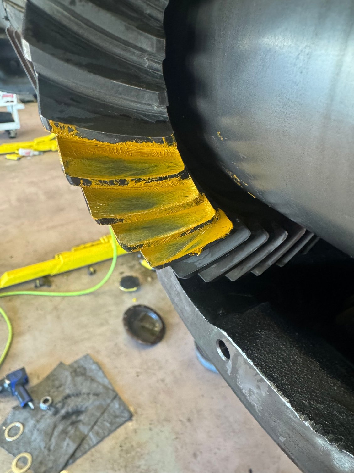

Swapping from 3.23’s to 3.90’s with an Eaton Trutrac on a 8.6 GM 10 bolt, first time setting up a rear end, I know this pattern does not look good, but what do you guys think will help? Has a whine all the time

Pinion sticking out too far, pull shims off pinion gear, and THEN, if necessary move carrier over to the RIGHT a little bit ?
I am NOT expert, having only set up a few ring n pinions, and got real lucky each time.

yep, REMOVE some shim from pinion

I know its a Gm,, but if you can find a copy of the Dana Spicer gear setup manual its priceless for learning how to do gears..

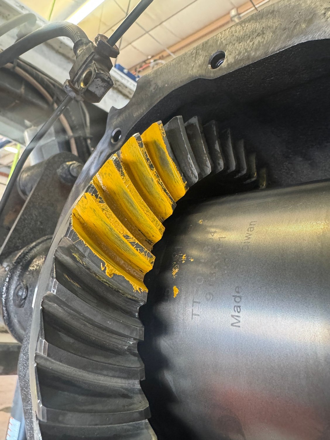

I figured out the problem, how does this pattern look? .006 backlash

Looks NICE.
Fill it with 75W-90 synthetic,and RUN it.

When I installed everything the first time, I installed a new pinion bearing that came with the gear set and I reused the old bearing races because they looked good still, turns out the new bearing is oversized and needed a bigger race in which I had to install, and after that everything was good
