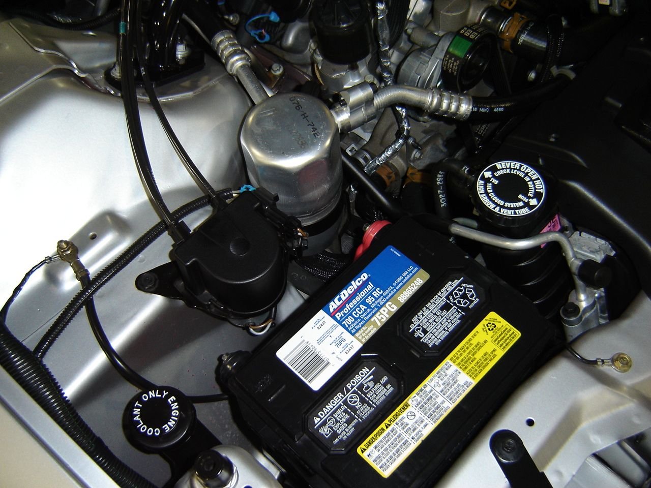

Also, you can look for the module mounted behind the battery, next to the AC canister in the engine bay. It's got a black top and has cables running between it and the throttle body. If this module ISN'T there, you don't have traction control:
