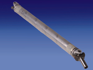

2 runs after my 12.47 run my driveshaft took a dump. I was launching at 4.5-5k rpms. Luckily a buddy of mine had a stock one lying around. I am planning on upgrading to a chromoly driveshaft and a drive shaft loop when I do a 12 bolt. check out the pics:

Good thing it didn't cause any major damage. Makes me reall want to consider what kind of driveshaft I get before I start driving my car.

that's pretty common, my buddy and i twisted a stocker aluminum one on some stroker 383 LT1 car that he was tuning....so my stocker went in the custo's car and away it went

Same thing happened to mine.

I would like to analyse that fracture.
How far would something LIKE this get you? Would it hold?? It is expensive, though...

how much power are you putting down? i broke mine last night, and im COMPLETELY STOCK. dead hooked ON STREET TIRES at a 3k launch...im just boggled that my rear didnt go first.

When mine broke it bent my brand new torque arm, I called eddlebrock and told them it had bent on its on and they gave me a new one.

Welcome to the broken driveshaft club! Yours looks just like mine when I broke it at the local drag strip, same location mine failed.
I wouldn't count your chickens before they've hatched. You might have caused damage to your rear without it showing any real signs yet (excessive shavings/chunks of ring/pinion gear in the fluid). Only real way to know is to take the cover off and inspect the internals. I thought the same thing as you when I took out my driveshaft. I later found out that I took out both the driveshaft and carrier at the same time.

looks like ur tq arm is till attached to trans end and u r launching at waht rpm! man I'm surprised thats all u broken. be carfull.
