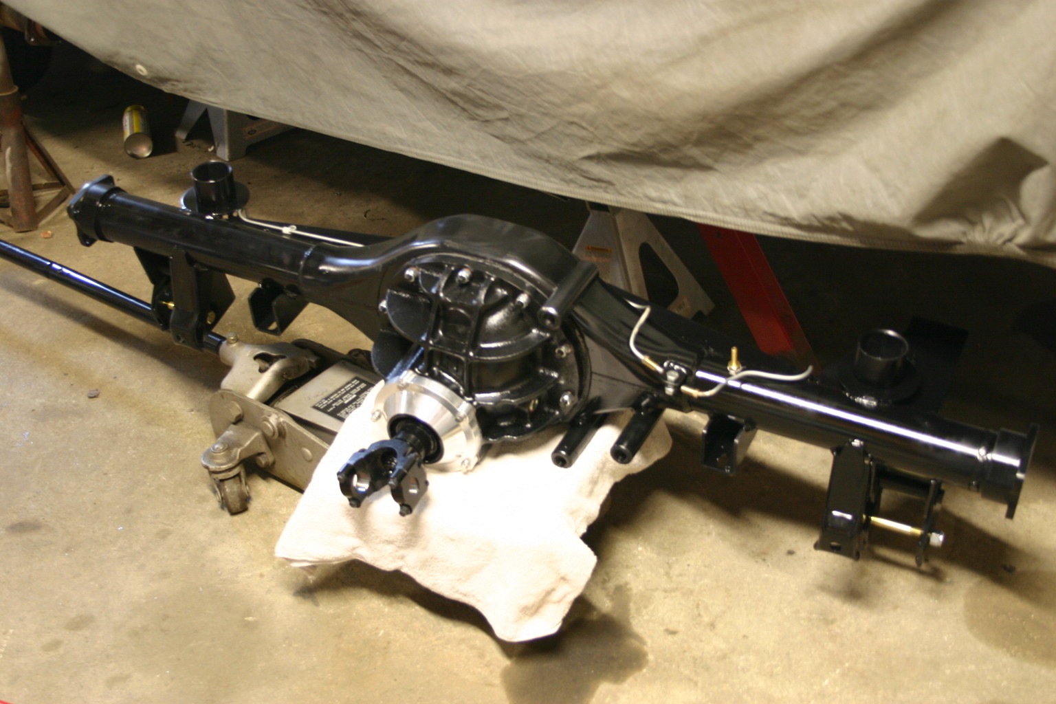

I took a piece of 1/8 inch flat stock and welded it fast to the rear with a hole in it and just used a bolt to hold it fast. its kinda hard to see in the pic but you get the idea.
