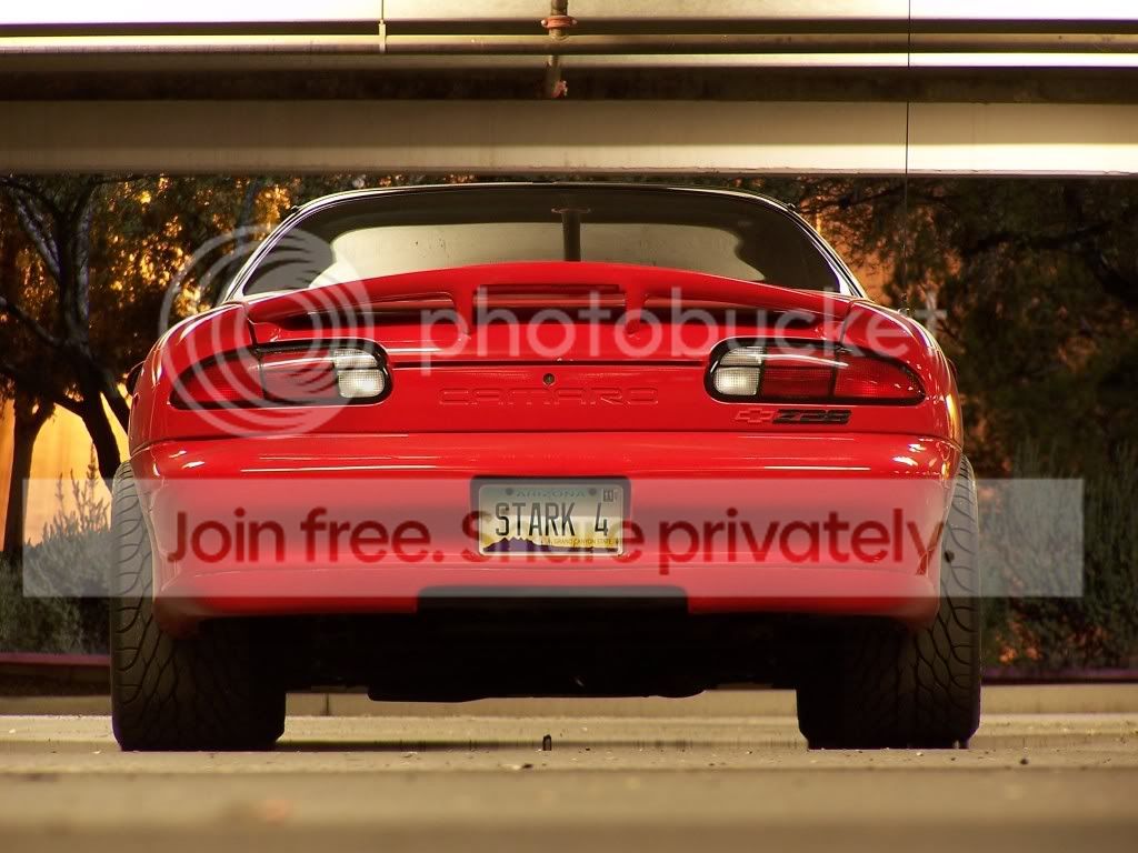

Can anyone tell me why my left wheel sticks out about a half inch farther then my right??
Mods are in the sig, I am guessing it my non adjustable PHB but not sure and dont know how to fix it. And no it is not the angle of the pic, I checked just now and it is off a bit.

from what i read, that's the PHB's job. you are correct. but then i also read that it's not dependent of how it looks but more of how centered your drivetrain is or something.

yep i'd recommend and adjustable phb and an alignment

damn those are some wide tires

Yeah I thought it was the PHB but I never noticed till I had the rear quarters as a marker on the tire lol. So once I get an adj. phb its a matter of a few turns and problem should be fixed correct?

correct. when i got my car..it had a adj. phb.....and it was off center alot more then that....almost an inch. got under there with a wrench..and it sucked it back it right to where it should be! easy fix..

make shure you get a double ajustable phb so you can aj it on the car that makes it easyer.

Damn that thing come with four wheel drive too I keed I keed... Sorry No i like the look of the car. Just adj. PHB should do the trick

How are those big meats not rubbing like a ****** with the rear that far off?

The tires have about 1 3/4 inch worth of clearance from the rear quarter. I have drag packs in each rear spring at about 30psi to keep them from rubbing. However it does make for a bumpy ride.

agreed with above, adjustable PHB is the only way to go.
