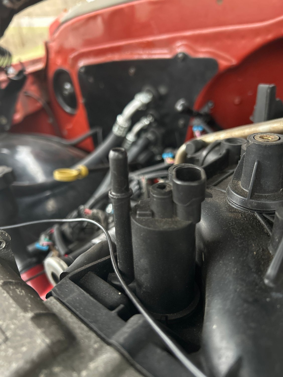

I have this 5.3 out of a 2003 Tahoe. I’ve been getting it dialed in, but I have no idea what sensor this is. Please help. Thanks!

It's the EVAP solenoid.

thank you for that. I have somewhere to start now. Does this need to be hooked up on a swap?
I imagine it’s causing a vacuum leak but the engine seems to be running fine.

It's for evaporative purge from the stock gas tank. Not needed on your swap. Take it off and install this : https://www.ictbillet.com/products/l...BoCngMQAvD_BwE
thanks! I figured as much but I’m pretty new to this engine so it helps to have confirmation. Thanks again!
