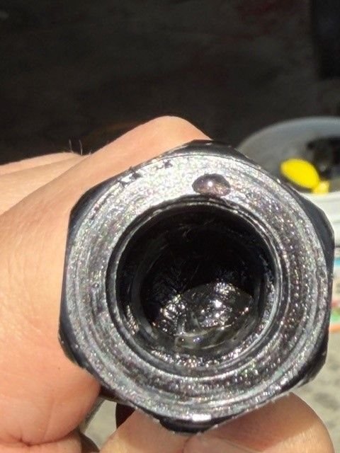

Old Mar 25, 2026 | 05:51 AM
Y2K_Camaro's Avatar
Joined: Sep 2009
Posts: 256
From: Wilmington, NC
Well, problem solved. I'll still change the valve seals to what BTR recommends. But my issue was right here. Clogged 10an hose that goes from the valve cover to the catch can, 100% blocked. Rubber in the hose broke down and collapsed on itself. Crankcase pressure was through the roof, pushing oil out of whatever seal it could, causing both tailpipe smoke and oil leaks onto my turbo crossover pipe. Good lesson for some to learn, always check your ventilation.
Old Mar 25, 2026 | 07:03 AM
Tommy42088's Avatar
Joined: Oct 2022
Posts: 1,675
Likes: 583
From: Louisiana
wow that wouldnt be one i would expect, at least you figured it out. Lucky it didn't blow the rear main. Good reason to weld an bungs on the valve covers and use AN lines.
