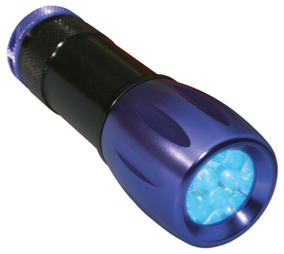

Check your compressor and see if it's wet from any compressor oil, that would be the first place to look. But yeah, get a gauge on it and try to get some pag oil with the leak detection dye in it
Drive the car for a while with the a/c running and then use a fluorescent flashlight to see where the leak is if you have one.
Description for the blacklight....back to the 70s folks
http://www.prosounddepot.com/Ultra-V...-Prodview.html
