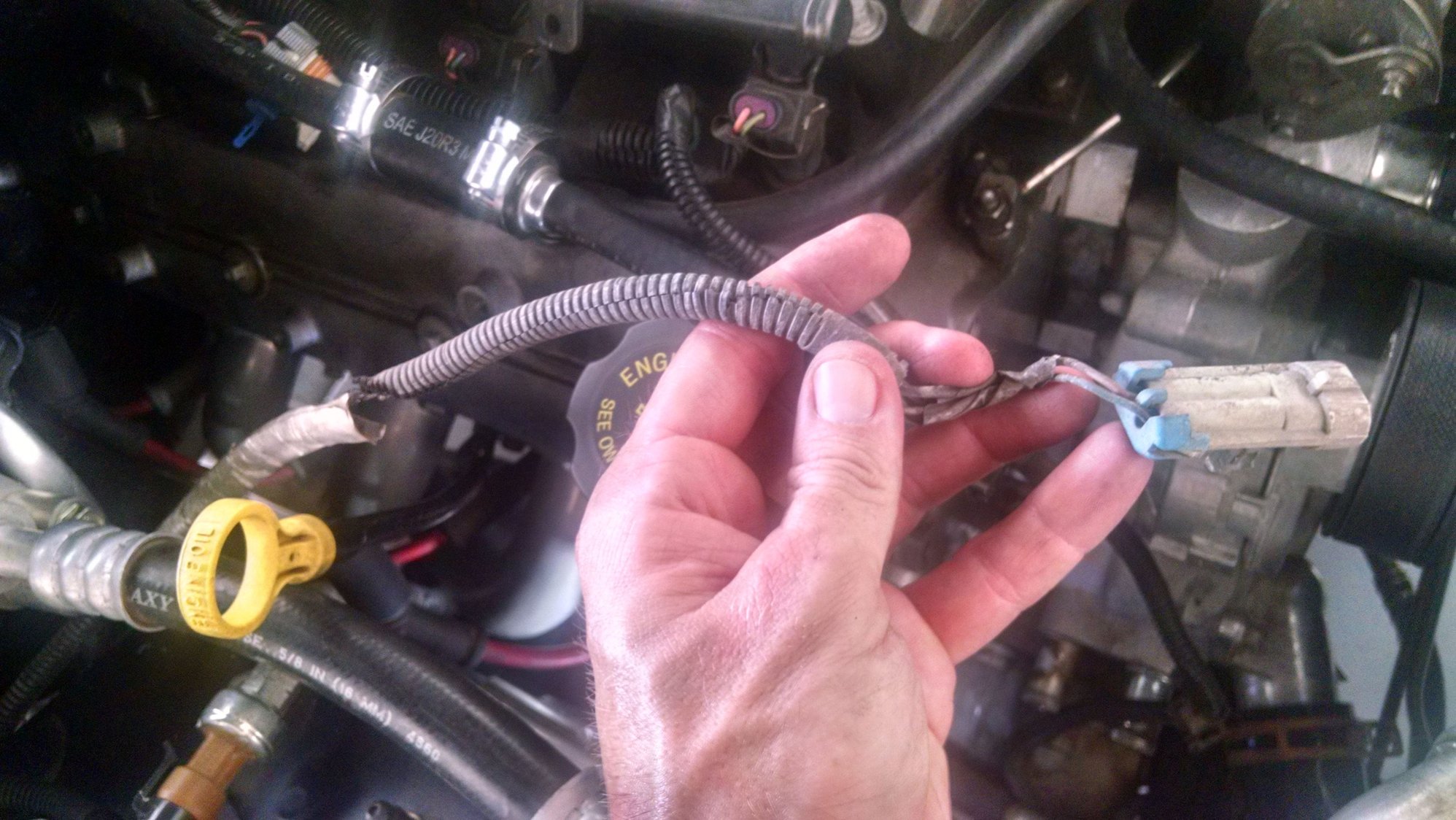

So I've been dealing with intermittent dash lights (SES, ABS, Trac) for a year or so. I've solved most of them with improving my grounds in the engine bay but still had an occasional ABS light.
While swapping out all of my coolant/heater hoses, I discovered what looks like an ABS sensor wire on the passenger side that had almost been eaten through by my headers. It runs vertically along the passenger fender, over the heater hose assembly, to the lower A arm. Solved it with some spare wire and solder, no more ABS light.
Just wanted to share in case it helps someone.
