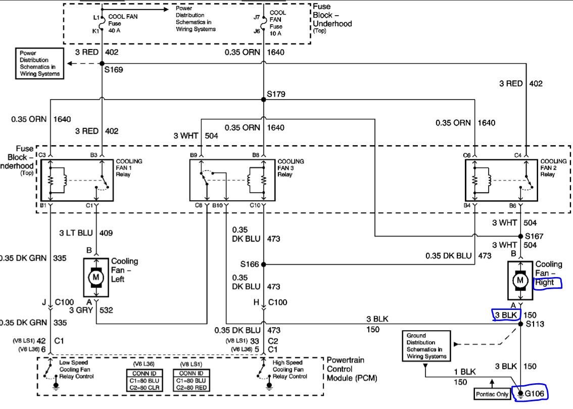

So I discovered that one wire (black) on the right (passenger) fan is cut.
Discovered this after overheating on mountainous roads during a short vacation.
From what I can tell on the schematics, it is a ground. Before even seeing this I had assumed it was positive; crudely spliced and put on a positive contact and it worked. How could that be if it is a ground? Also, why would it have been cut in the first place?
Can someone point me in the right direction here?
2002 3.8 A4 Bird

The cut in the wire is where you have the diagram marked "3 BLK". If you put a 12v power source on the fan end of that cut, the right side cooling fan will run when the computer commands high speed. It's not the way the system was designed, but that will be the result. My recommendation would be to repair it so that it functions as intended, it is a very good cooling strategy.
Old Apr 10, 2016 | 08:40 AM
eseibel67's Avatar
iTrader: (10)
Joined: Feb 2008
Posts: 1,781
From: Kitchener, ON
As a matter of fact, in the fan will be running backwards and pushing air into the ran instead of pulling. Fix it properly.
