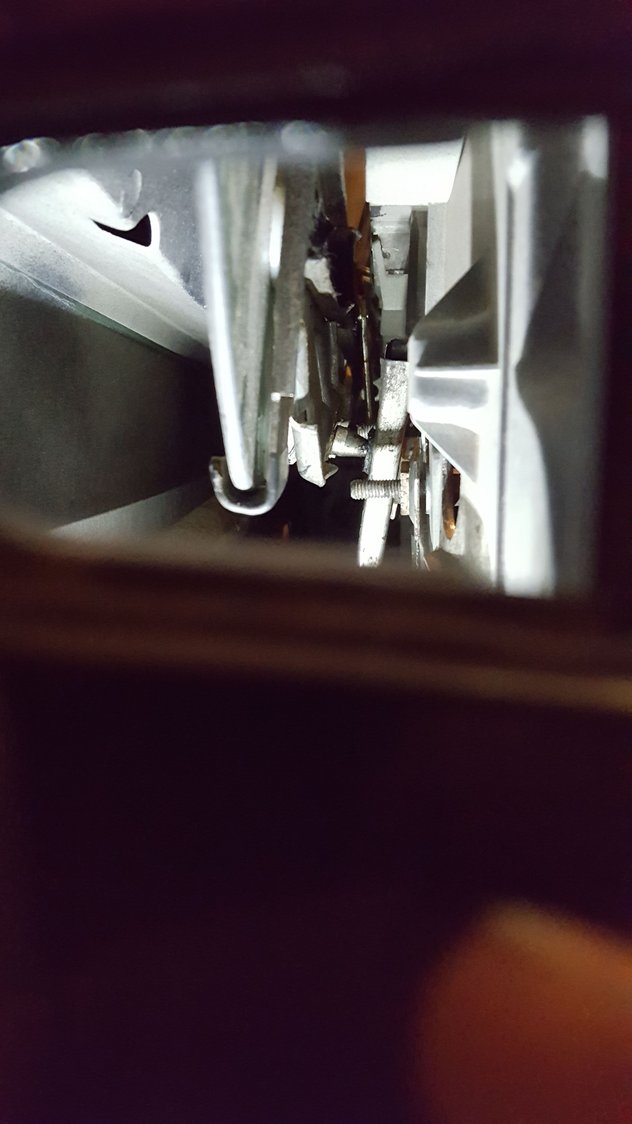

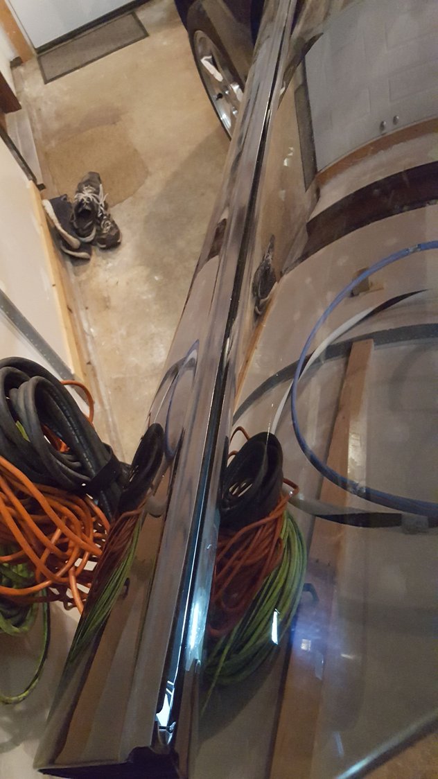

I have a gap between the outside of my window and the pane itself. I looked at the door with the panel off but I'm not sure what is causing this. When I took the weather stripping off the window could be pushed out but the stripping when installed pushes the window back in.
Looking Through the hole on the door jam
Is this bend normal
Gap from above
As it sits

In your second picture it shows the window track that the window runs up and down.there are two 13 mm nuts with either a torx or a allen center.This is how you move the window in or out.

You have a loose roller in a track. Looks like you have this problem: https://ls1tech.com/forums/general-m...dow-guide.html
