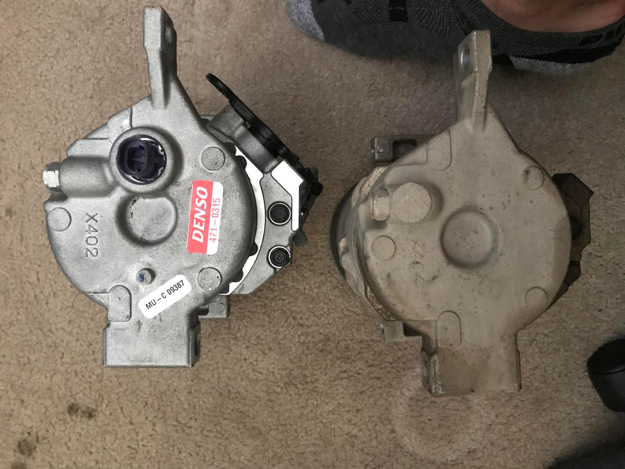

Hey guys, I have an 04 silverado and I'm replacing the AC compressor. On the original, there is only one plug on the entire unit which is a two-prong plug on the side of the compressor near the front. On the new compressor sent to me by rockauto, there are two plugs. One plug on the side and a new circular purple plug on the back for which there is no connector on my truck. I know this connector is a pressure switch to shut off the compressor if it overheats but my truck doesn't have the plug for it. Can I still use the compressor without this plugged in or will the clutch remain disengaged? Is there any way I could bridge the two prongs to make it work? If I can't use it, and I have to return the part, which compressor should I order to ensure I get the right connections? I have done some research and it seems the camaro compressors don't have this plug but I can't imagine they would mount the same as a silverado. I obviously ordered this specifically for my truck but seeing as how rockauto sent me the part they think was correct, I have to pay for return shipping and I'm not sure how I could prevent this from happening again. They really boned me here.
Any advice is appreciated, thank you!
