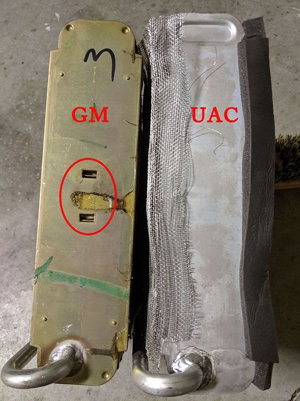

I wanted to get some opinions about this, so here goes. I'm replacing the majority of the A/C system in my 1995 Camaro. New compressor/evaporator/condenser etc. The problem is the evaporator. It was fun enough getting to it, and then I discovered that the replacement part I have for it doesn't have the mounting holes for the bracket to screw the evaporator down (see attached picture). I searched other options for the part, and bought a different brand (Four Seasons) after pictures showed their part having the mounting holes, but no it doesn't. Customer service has been non-existent and it's a guessing game as to whether the mounting holes are present on the aftermarket stuff. I now wonder if any of the aftermarket parts are correctly made.
Yeah, I could just install the evaporator and forget the bracket, but I don't like not securing something correctly. Nothing else really holds the part in there except friction where it pushes into the engine compartment. The evaporator is made of aluminum, so modifying the bracket and using adhesive is probably not going to hold up. What should I do here? Anyone else have this problem with new evaporators?

I'm currently working on this. UAC is a no go, and Four Seasons shows the correct stuff but isn't. I suspect that TCW is the same problem. I'm going to be buying a Spectra brand evaporator soon and will see if it's the right design. The pictures are correct, but you never know what you'll get in the mail.
I worry that finding some NOS ACDelco one might be the only correct part.

Yeah, it's a stupid problem of some aftermarket not copying all the elements of the original part correctly and all these companies are just selling the same thing.
On the original part, the back plate with the mounting holes is just that...a solid plate. On the UAC one I bought, the back plate is also the outer wall of a cooling tunnel/chamber so you can't drill your own holes.
To your earlier question, I could barely get any response (and it wasn't helpful) from UAC. Four Seasons had no obvious customer service contact and seems to be geared towards dealing with businesses. Spectra got back to me and said they actually aren't making/selling the part anymore, though they are still available. Suggested I contact the seller to ask about the holes. As if Amazon or Rockauto could tell you anything about that.
I don't really want to reuse the old evap because it's 25 years old. I've got all new parts otherwise so I think this should be as well.

Well after buying yet another brand (TYC) and it's the same part, I just gave up on buying the available aftermarket versions. I found a place on eBay selling a few NOS GM/ACDelco evaporators and went with that.
