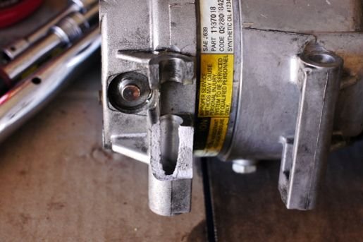

This happened when I was re-installing the original GM low mileage compressor, torqueing the bolt to the spec 37 ft/lbs (never got there). This compressor works perfectly fine, hate to have to replace it. I have the 2 missing pieces, any chance if I JB Weld them on, it would hold at a reduced torque?

Get somebody to TIG weld that piece back on. JB Weld won't hold up to the strain of that bolt.

Update: I fixed it with jb weld, installed it again, then filling it with oil discovered that the case was cracked too (invisibly). So here's a tip: when you install one of these, do not tighten the bolts to the torque specd in the service manual, the case and bolt flanges are just too thin.

I've pulled mine off and on several times now and used 36ft lbs on the torque wrench and have not seen this issue.
