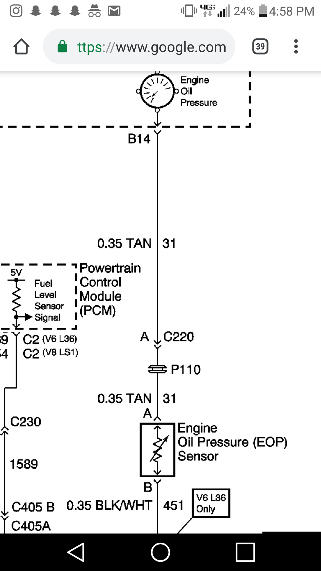

[QUOTE=booz;20242027]Mine did the same thing. It was maybe a broken cable. Put a direct wire to the back of the cluster. You need to check continuity of the sensor to the pigtail back of the cluster
Check my thread.
https://ls1tech.com/forums/general-m...eme-right.html[/Q
Would anyone know what P110 is if i were to run a wire is that somthing i have to worry about or is it a stright shot from sensor to gauge ?

Old May 10, 2020 | 06:23 PM
Supercharged111's Avatar
Joined: Dec 2015
Posts: 931
Likes: 153
From: MI
P110 is more than likely one of the plugs behind the passenger kick panel. That's where the harness comes through the firewall.
