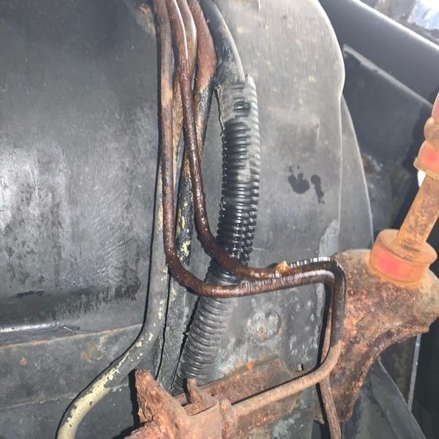

Brake line off of the ABS block Is corroded all the way near the rear left caliper any suggestions. The line goes from the ABS block all the way back.

Replace all the lines. The ends on the flex lines look awfully rusty, those could be a pain/mess. Probably time for some new flex lines anyways, they dont last forever.

I just ordered this set Classic tube C a 1052 – SS.

Good to see you ordered the stainless steel kit. I also live in a rustbelt area, northern Ohio.
Since you have 4 channel traction control, you'll need the 6 piece SS hose kit, 2 for the front calipers, 2 for the rear calipers and the 2 that jump from the body to the rearend.
In 2018 I did the back area of my 3 channel system because of rust. I converted all the hard line connections to -3AN as I didn't want to work with all those inverted flare and bubble flare connections.

Do you think it’s possible to do this on jack stands?
