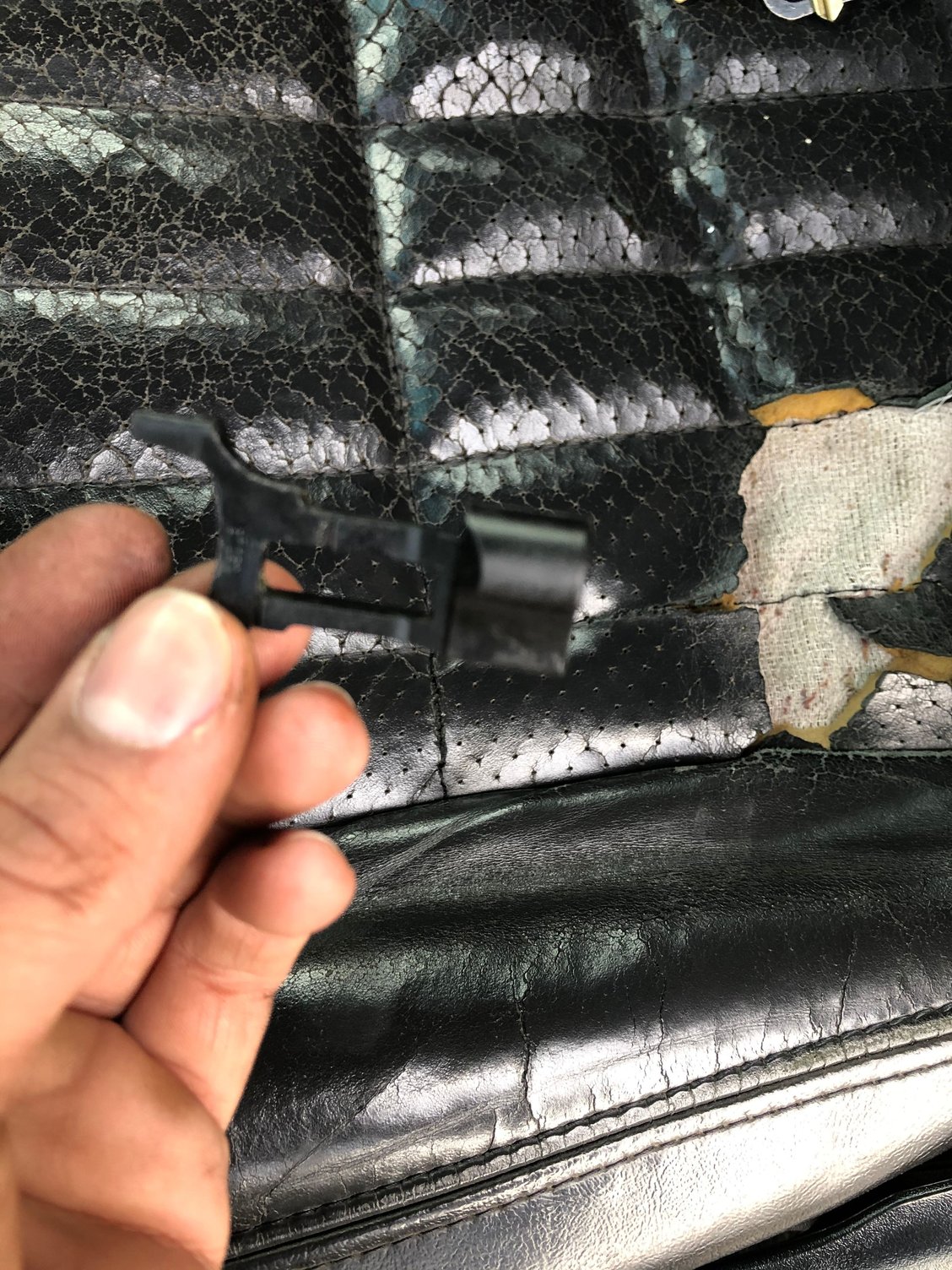

I was messing around with my high beams the other day and this piece fell out. I tried to get it back in and I can’t figure it out. I thought I had a basic idea of how the piece goes in but when I pull the lever it pushed the rod sideways rather than straight back. Any advice or pictures would be greatly appreciated.

Common problem. That's the high beam follower. This thread has the links to the instructions to get it all back together: https://ls1tech.com/forums/general-m...ts-switch.html
