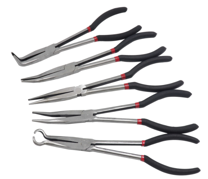

I will be replacing my plugs and plug wires once I figure out how best to get my hands onto the back 2 cylinders of the passenger side (without removing the air compressor or the starter). Seeing how tight of a fit it is, and the odd angles, what has been found to be the best tool for the job? Are the needle nose double offset pliers type just as good as I hear or are the offset dedicated puller type tools able to get to the back cylinders ok? I know the old screwdriver with the curl on the end would work well due to the lack of clearance needed between the manifolds and wheel wells and I hated using these in the past as I ended up pulling wires off the boots 30% of the time. At least I tried the passenger side before starting to take any off this time, that way I didn't end up with 5 or 6 new plugs and wires and 2 to 3 old ones!

If not concerned about reusing them you can use the long handle/long reach needle nose pliers to remove some of them. The 45 degree offset ones or the hose style pliers of the right diameter work well for that type of stuff and if they are offset you can use them to pry away from the engine. You just have to find the right spot to grab on the middle of the plug on the wire. Don't forget to twist the wire back and fourth a few times first to break it loose, if you can. These are available at most auto part and some big box stores.
Lastly, have band-aids ready.
