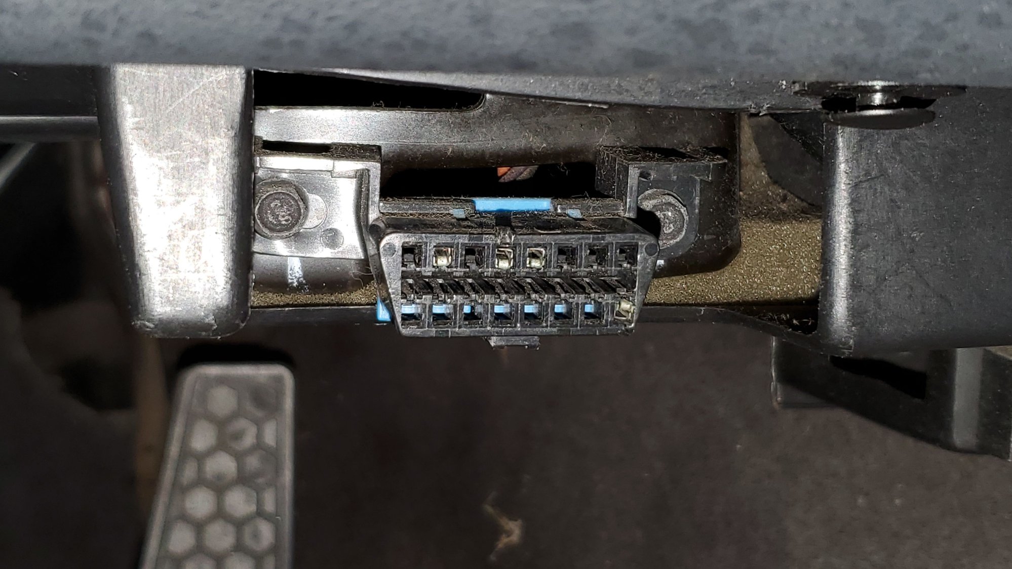

My obd2 scanner no longer turns on when I plug it into the outlet on my 99 TA and I confirmed that the problem is on car end. Is there a dedicated fuse or relay to this outlet? The outlet itself appears in order so the problem's likely elsewhere...

Check the accessory fuse in the dash, and try pulling the cigarette lighter before trying again. Sounds weird I know, but I can tell you first hand it's a thing lol
